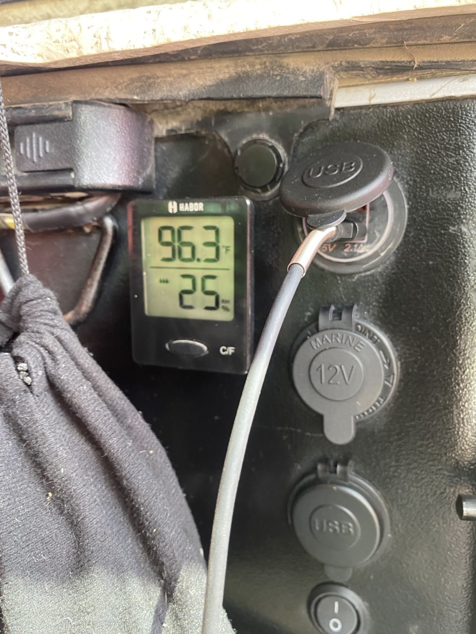

    Mine are just mounted right into the bedsides.
    3 down each side. Dielectric grease the shit out of the connectors and they’ve been fine for 5+ years now.
    You could find a plastic waterproof “hobby box” to mount them into if you didn’t want to make holes.
