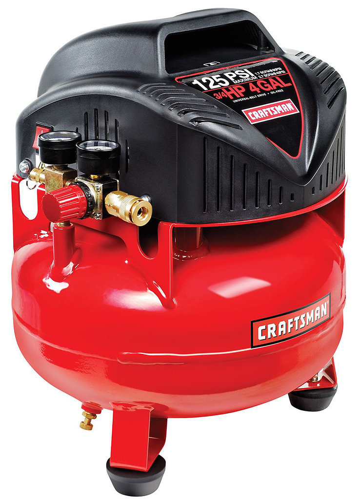

    I used it with my little pancake compressor the other day to blow up inner tubes before a float down the river - it ran a little slow but it worked. Bonus: I had a crowd of bikini clad gals asking me if I could blow up their tubes for them.

    Must be a very small compressor? I have a little fella (see below) that only draws 3.0 A running, never tried it with the Taco inverter but I will sometime--could be something useful you could do with it...

    It's just an older version of this one.
