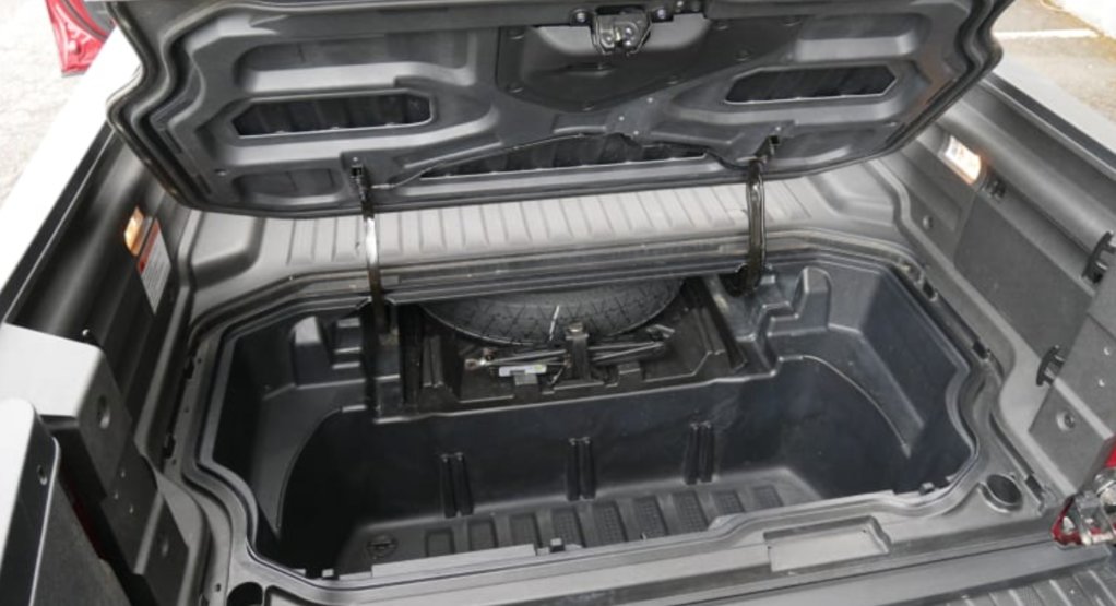

    In terms of my original post, I was referring to cutting in the floor of the box, not the cab. Pic below is what the Ridgeline has which obviously can't be replicated as big as this in a Tacoma but was thinking some smaller version of it.

    Won't be the same. The Tacoma has frame rails running under the bed where as the Ridgeline is a uni-body so it doesn't really have a "frame."

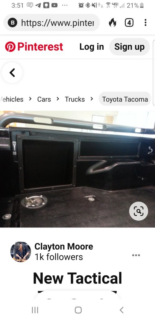

    Ive seen someone make storage compartments into the bed sides...

    I'm familiar with the Ridgeline setup. I've looked at their dual-swing tailgate a number of times...
    The Ridgelines lower space is in the same area as the Tacoma's spare tire. You'd need to either go without the full size spare, or mount it somewhere else.
    There is that Australian company that makes pull out storage areas behind the tail lights, but actual purchasing seems to be difficult. Price quotes I've seen also are expensive(involves a comma, per side), and they seem to only make a global model for the Toyota Hilux, but not one specifically for the american tacoma
    But the Hilux and Tacoma are likely similar enough to only need minor modification to work.
    But if you wanted to try the trunk idea, biggest step is going to be figuring out the closure/fastening/stop method, and how to add stops and trim to the opening. Most times in fabrication, this would be done by purchasing 1-4 additional sacrificial parts, and then cutting them up to make one cohesive assembly.
    In this case. You would need to purchase additional truck beds(check scrap yards for trucks with front end damage), and have some very good fiberglass/composite building skills.
    A real professional finished idea, with a gasket like the Ridgeline, could easily end up costing upwards of $10,000(gotta figure no yard will let a composite bed out for less than $2k-5k, then there's a couple thousand in composite materials, and then at least 2 months of full time work in sanding and prep)for a custom project like that. Far more if you were to pay shop labor prices instead of doing the work yourself.
