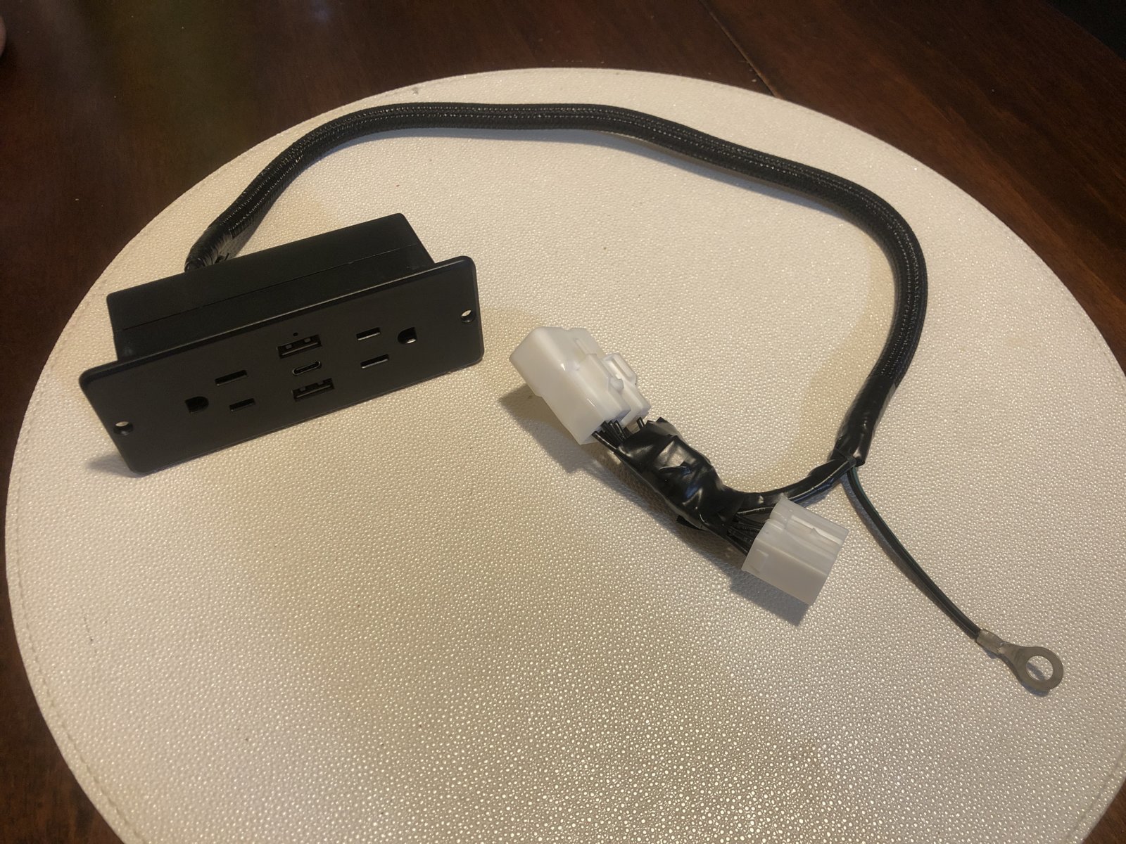

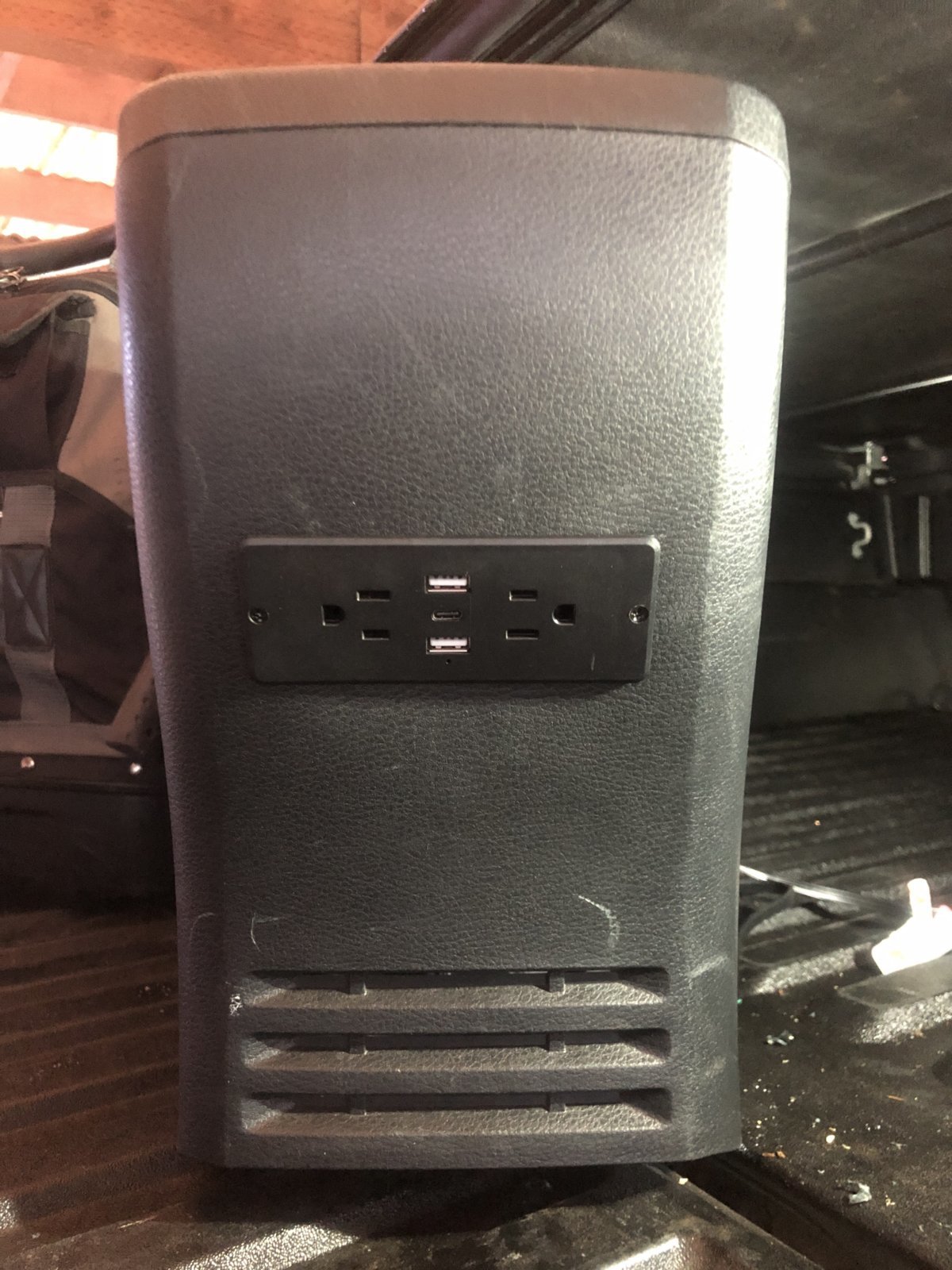

    I wanted to share this plug and play harness I built (see pictures).
    The harness puts 2 120VAC, 2 USB A, and 1 USB C outlet in the cab.
    The harness plugs into the stock AC inverter.
    The harness is plug and play. Absolutely zero wire splicing, can be removed and vehicle returned to stock at any time.
    The outlets are placed into a cutout in the center console.
    This is handy for giving backseat passengers USB ports, too.
    Huge shoutout to numerous Tacoma World members and forums for helping with the pinout and electrical diagrams to get this right!
    If there's enough interest I was thinking I could build up a few and sell them to those who are interested.

    OEM inverter is ONLY 3 amps output (A/C)...

    Exactly. The AC outlets are mostly for convenience. Same limitation as the outlet in the bed.
    High-power devices (saws, heaters, etc.) wouldn't really work here.
    Charging my work laptop in the cab has been pretty handy, though.
    Way better than running an extension cord from the bed!
    Thanks for pointing this out, @caribe makaira !

    This likely does not work in an SR. This harness mod I built requires the vehicle to have the AC Inverter box already installed. I don’t think SR has that. Quick way to tell, does your truck have an AC (3 prong household) outlet in the bed? If not, this mod won’t work. If so, this mod should work.
