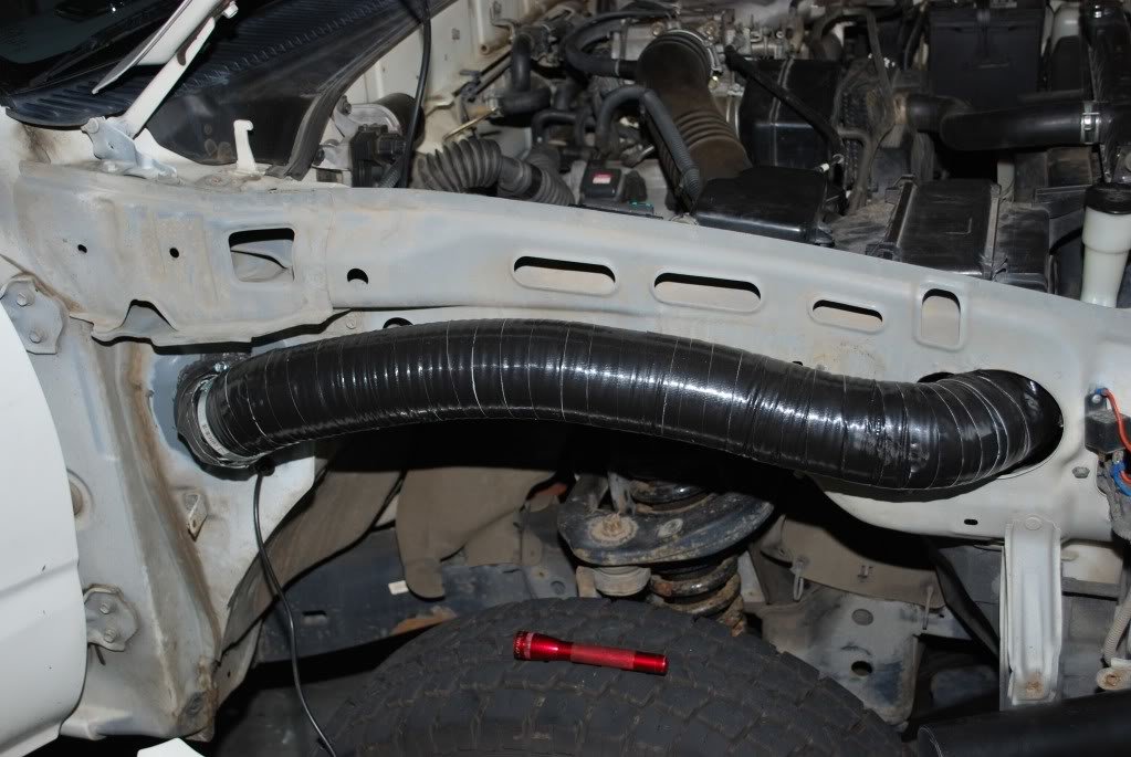

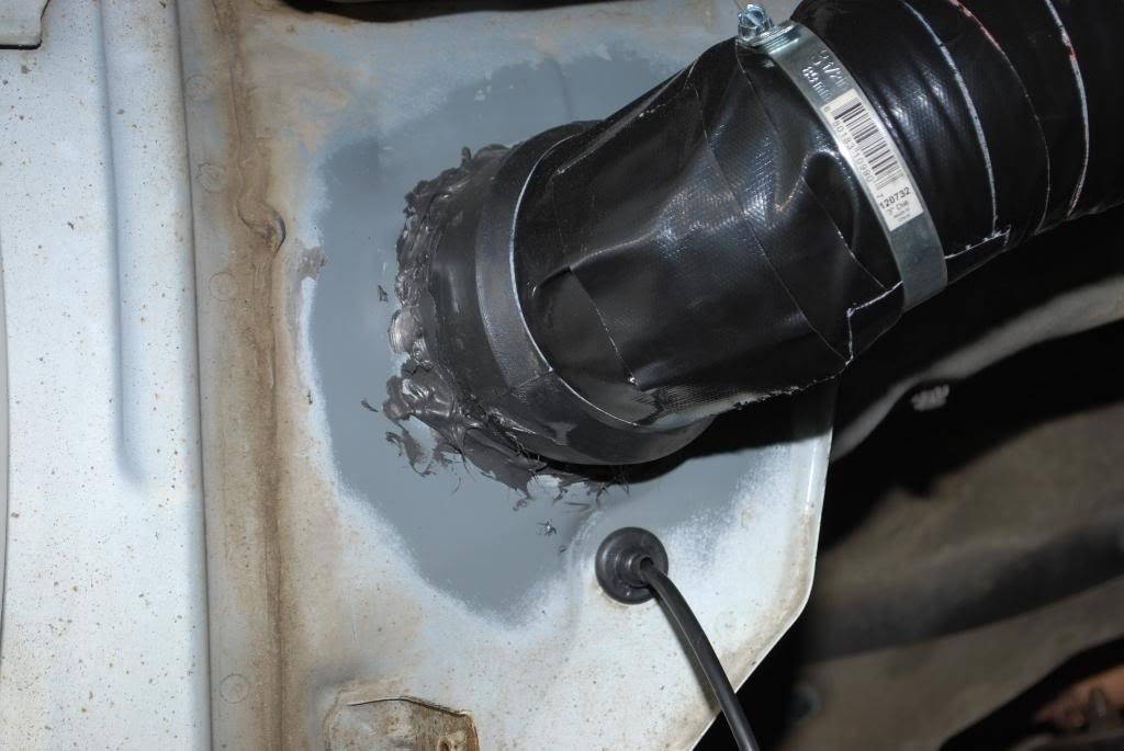

    i did this, when the deck plate isnt in, i put a towel in the side of the air box in the tube to keep from hearing the sucking sound majority of the time. It really isnt that loud though when its sucking from the cab. I used a 3" dryer duct on mine, fits pretty well!

    That looks like it could work really well. Those dryer exhaust tubes really aren't the thickest though, which is why you put the extra tape on I assume. Do you still have the plastic inner fender in place to help protect it as well?

    They aren't the thickest, but it's not all stretched out. It's mostly compacted still, just extended at the ends where it connects. The tape def helps make it a little thicker and keep it in tact, I used the gorilla duct tape on it. I don't have the plastic piece, there wasn't one in there though. The guy who had my truck before me had something like what I put in there, but it was really flimsy and wasn't connected very well. When I put the fender on, everything fit like a glove, it doesn't crush it or anything. What kinda stuff are you thinking about using on your truck?

    Your dryer exhaust sounds like it is working well, I may just have to copy you. Since I no longer have the plastic inner fender protector either, I was hoping I'd be able to find something a bit more durable. Since yours is lasting and the tube should have enough give to not crack if hit by a rock, I may have to go that route if I cant find something else.

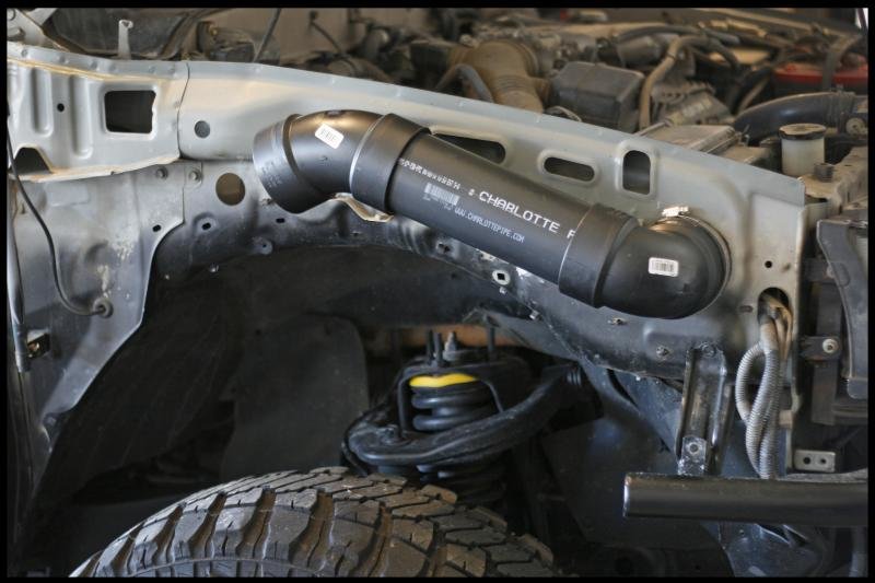

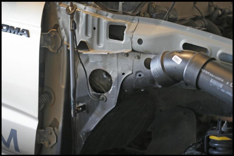

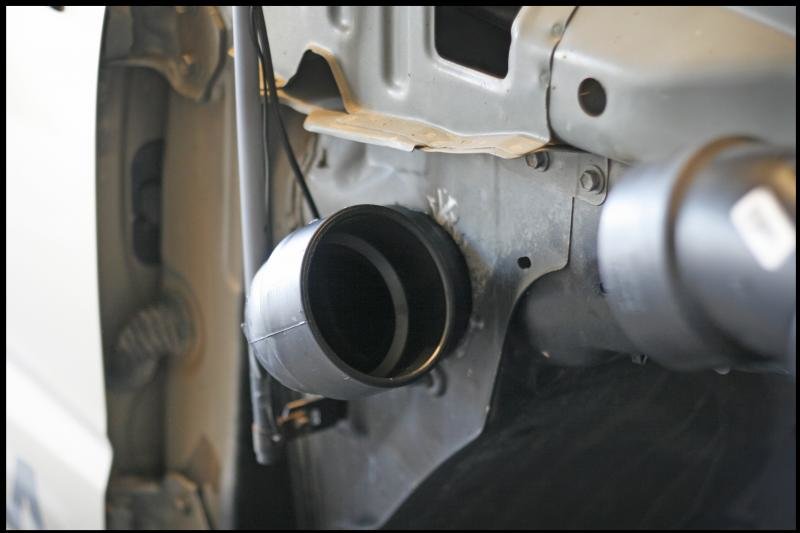

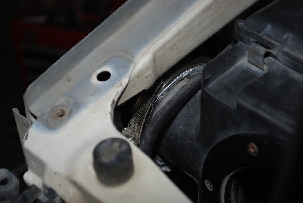

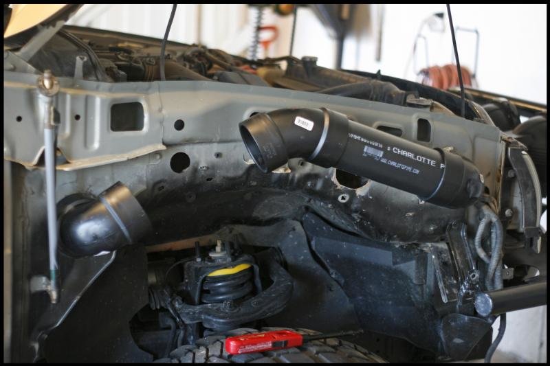

    Sure. It's LOUD!!! I got mine totally built and sealed up. As far as getting clean/cool air to the motor it's hard to beat the in-cab snorkel, but I couldn't keep it for more than a couple of days. It was ridiculously loud for anything but a race truck.
    Here's the pics of how I built mine. The above pics with the dryer vent and duct tape is stupid if you're going to do this. The dryer vent will leak and crack and the duct tape won't help much either and will just dry out and flake off after a while. I can see numerous places in the above photos where water would get into that system. If you're going to do this, at least do it right and seal it up.
    hole cut into cab
    The only way I could possible see living with this mod on a daily basis would be if you could easily cap off the opening inside the cab and run a deckplate mod on your airbox 99% of the time and only open up the in-cab portion when you are worried about water. But then......is it really worth the effort?
    I ended up changing mine and have the intake opening right up under the top of the fender where it's pretty protected. I used a 3-way elbow with a small opening at the bottom that I capped and drilled a small hole in the lowest point. If any water gets in it goes to the lowest point and drains out. You can also see where I sealed up the hole I cut in the cab.

    Like has been said, you can make this work with stock fenders if you keep it tight. I part that is the most difficult to fit is the elbow at the front behind the headlight. There is not much room behind the fender there.
