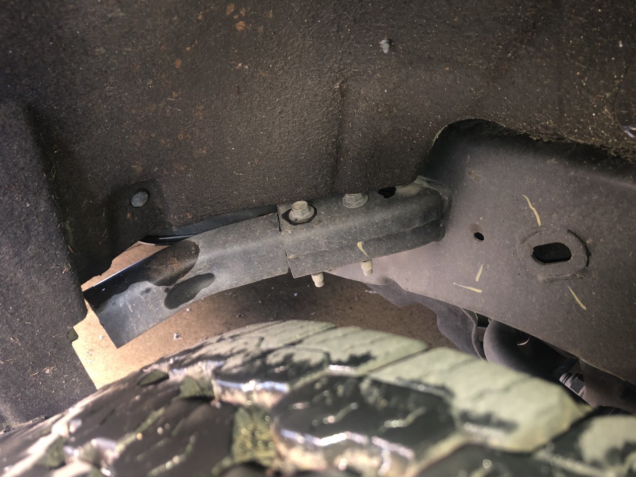

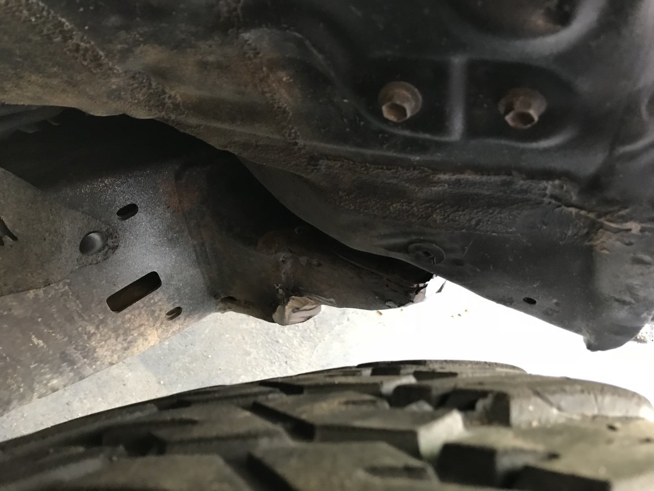

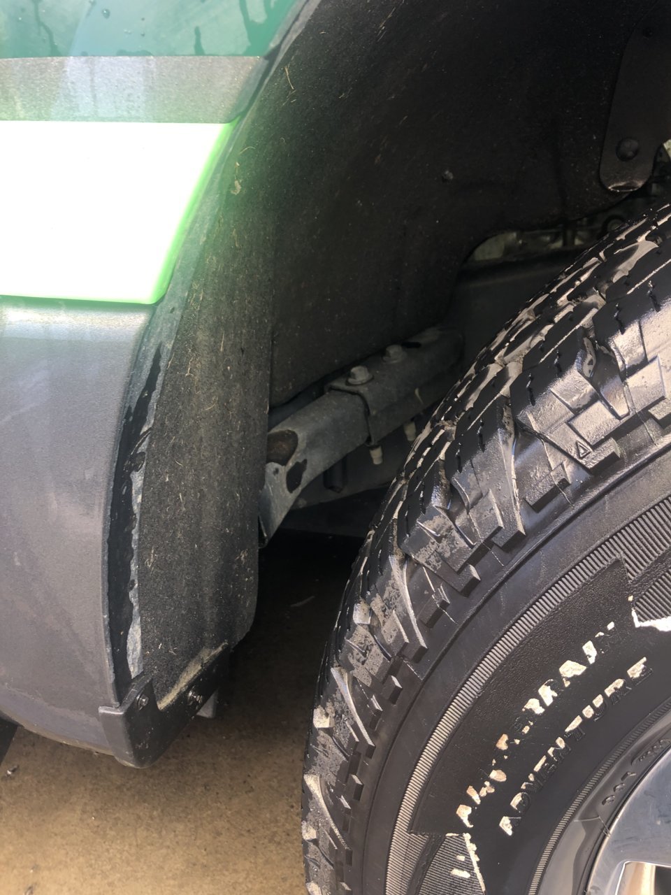

    For all the “cab-mount as crash-barrier” doubters, below are some pictures I just took in the front wheel well of my 2018 F150. One if the big factors in wheel intrusion and the desirable ‘glancing’ of the vehicle in a crash is the distance between the wheel and the cab (see page 6 of the paper below for a study of the affects of the gap between the wheel and the front of the frame in transverse and longitudinal engine cars)
    https://www-esv.nhtsa.dot.gov/proceedings/24/files/24ESV-000244.PDF
    Ideally, and perhaps counterintuitively, you want the distance between the wheel and frame minimized. To achieve crash-worthiness on the F150, Ford had to add these “wheel intrusion barriers”, or, if you will, “false cab mounts”. They serve no structural purpose, they are just there to catch the wheel in a crash.
