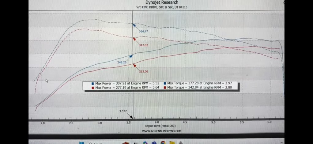

    I'll save you the time. From the video:
    8% improvement 0 to 60 time post tune.
    91 octane pre: 8.666* not sure which drive mode
    91 octane "sport" post: 7.97
    3 tune options.
    1. SR auto / manual trims -- restore detuned to SR5+ output
    2. Stage 0 (all trims) mild trans and boost tune
    3. Stage 1 (all trims) more boost and more trans tune
    Currently not available for hybrid models.
    Pre and post dyno, 91 octane 4,300' elevation. Level 1 tune.
    11% improvement in horsepower, 9.1% improvement in torque over baseline.
    Would love to see a pre/post auto transmission SR on this.

    Is that 342 on 87 and 377 on 91?
    what’s output on 93 we have that in Fl

    Both runs (Baseline & Tuned) were on 91 Octane and sampled on the same day. I don't expect the power to be much higher on 93 versus 91 as we're nowhere near the knock threshold, and these calibrations were designed to run regular-premium fuel.

    Thank you. I edited that. I misunderstood the video
