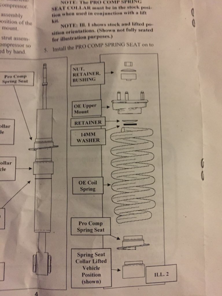

    I'm extremely frustrated truck should of been done today .thanks and also pro comp directions suck came with bushings and a sleeve that I see has no purpose might just use the old hardware as I'm reusing original top hat and dust cover .​

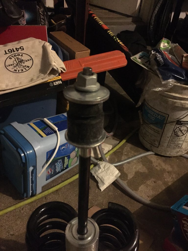

    Pro comp came with 2 bushings a 14 mm nut and a sleeve no idea where sleeve goes but bushings replace old bushings .

    Procomp hardware

    No where it shows sleeve

    Might of figured it out

    That's the supplied hardware without top mount

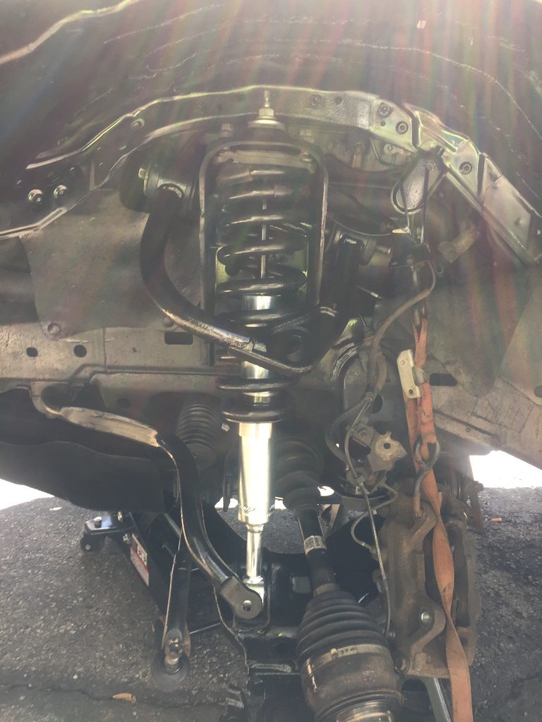

    Eliminating spacer and install these until I can get new fox coilovers I need it back on road by Monday can't get new coilovers for a week or so .

    That's the plan loosen the lower control arm let it lower and give it a shot .

    #147139
    140
    Now to put every thing back together .

    You took apart way too much stuff just for a shock swap. If you tied up your spindle before you disconnected it from the UCA, it wouldn't have pulled the axle out. Also brakes didn't have to come off either.
    This is my wife's 4Runner but same thing...
    You can see spindle tied off to the frame.
    Got TC UCAs installed and kings extended travel coilovers after.
