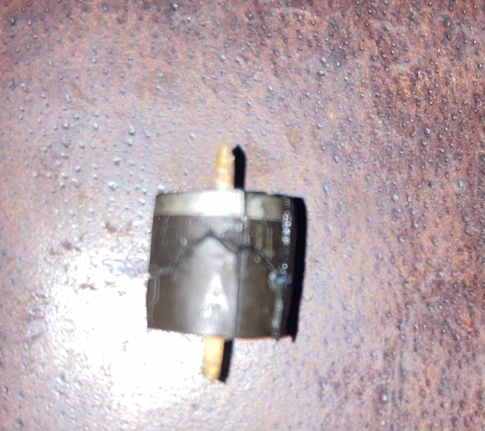

    Hi fellow members. Hope someone out there can confirm what this is. I think it’s an inline fuse but haven’t seen one like this before. My truck had aftermarket headlights in it when I got it and one has gone off and on a few times in last month or so so I disconnected it and bulb looked ok and I put some dielectric grease in socket. Went out again and I saw insulation looked burnt and smell of burnt wires. Cut insulation and discovered broken, burnt what I assume is fuse. Has GW 10 A on it. Picture shows what I’m talking about. Anyone know where I can get one like this or can I install another type?

    Hard to tell in the blurry pic but it looks more like a diode.

    Can you provide a better picture so we can identify it by the markings?

    I’ll try to get a better picture. I thought it looked more like a diode also but I didn’t see a direction arrow or anything like that on it. It’s hard to get good picture because it’s broken but I’ll try

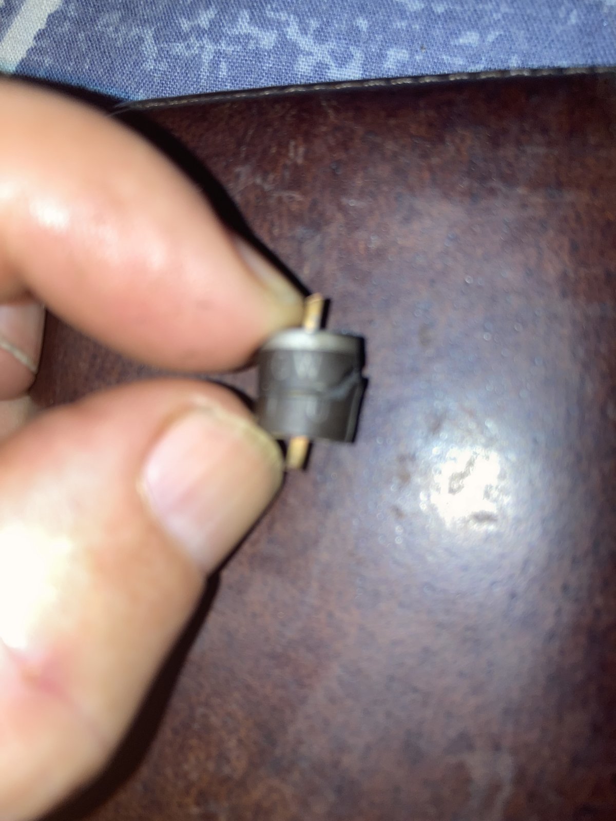

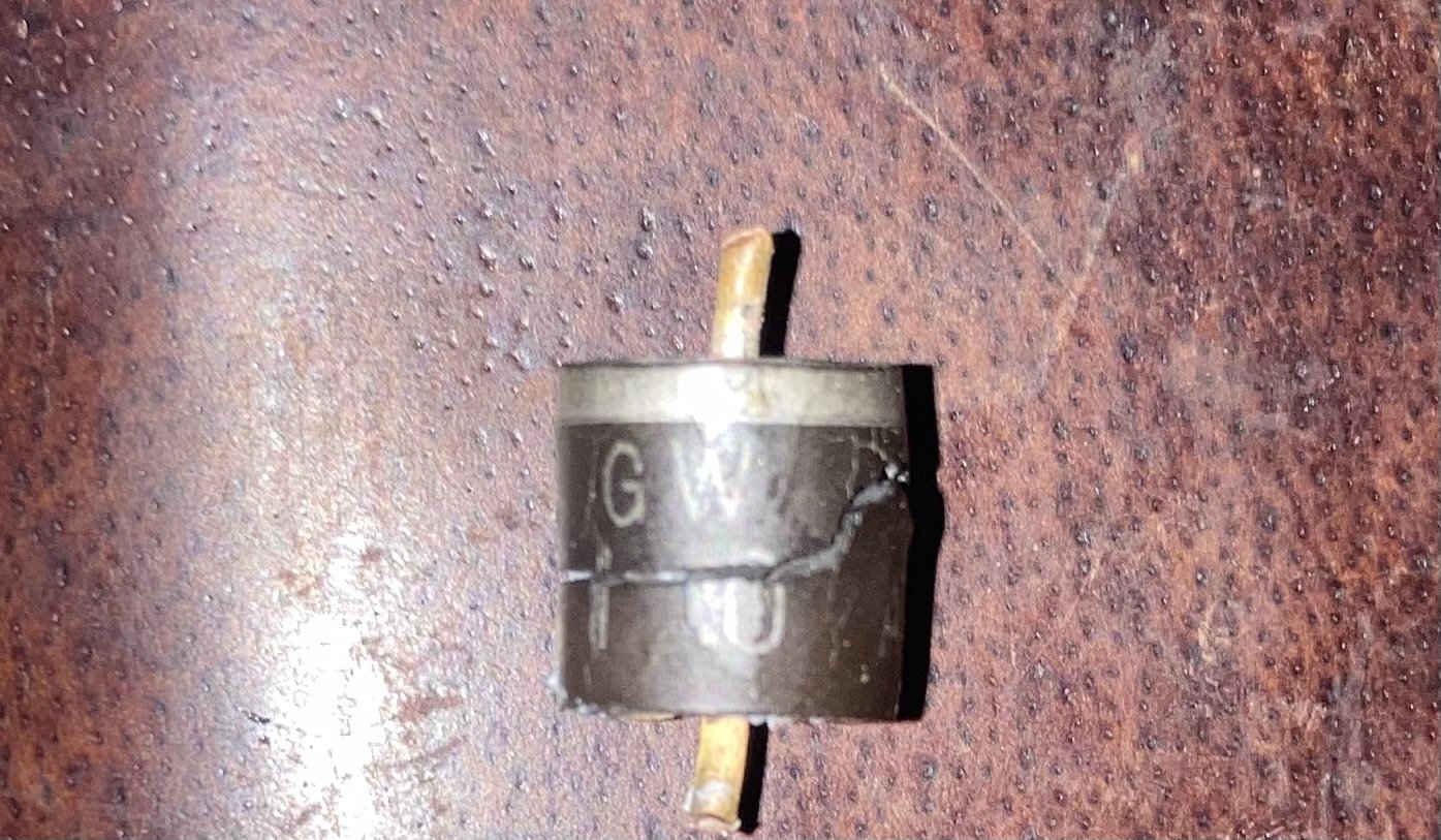

    Here are the best ones I can get. Like I said I think it has G W 1 0 A. These are only letters and numbers I can see. Not sure if anything else where it is broken or notIMG_3792.jpgIMG_3791.jpgIMG_3789.jpg

    Possibly a Goodwork Semiconductor 10A diode. Not sure if it’s a TVS or a rectifier. Might need one of those angry pixie wizards to pipe in here.

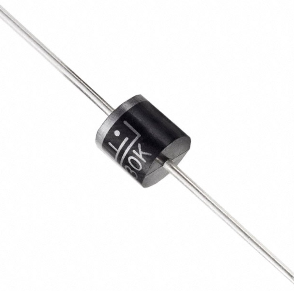

    Just a 10 amp rectifier diode. You can get them from Amazon

    They are using a high amp diode to keep the low beam active when the high beam is triggered. This is done when you have projectors with a shield that lifts when the high beam comes on instead of triggering a 2nd filament or high beam bulb.
    I did this on my wifes car when we switched her headlights to oem projectors. I created a wiring harness with a diode between the low and high beam wires.
