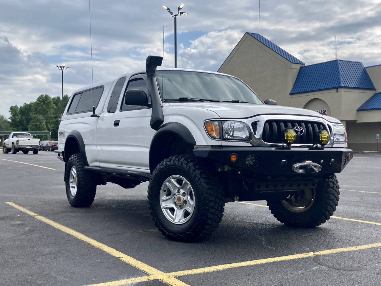

    That's a super nice looking truck.
    6Lucky6[QUOTED][OP] likes this.
