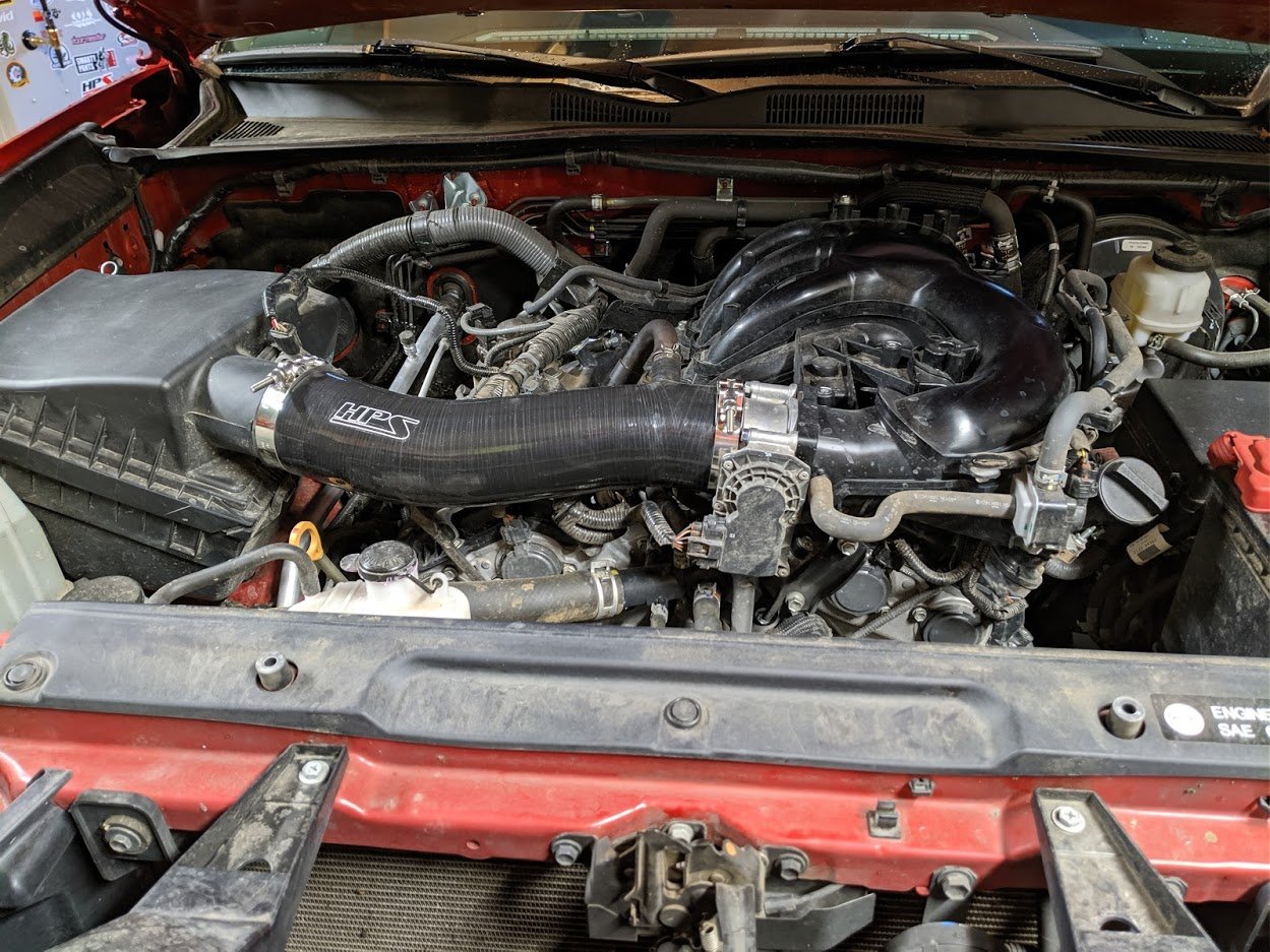

    As was noted above, this motor won't do anything with a CAI or cat back. In fact, you already have a CAI that uses the Tundra airbox. You can get rid of the dingus for less than half the cost of a CAI:

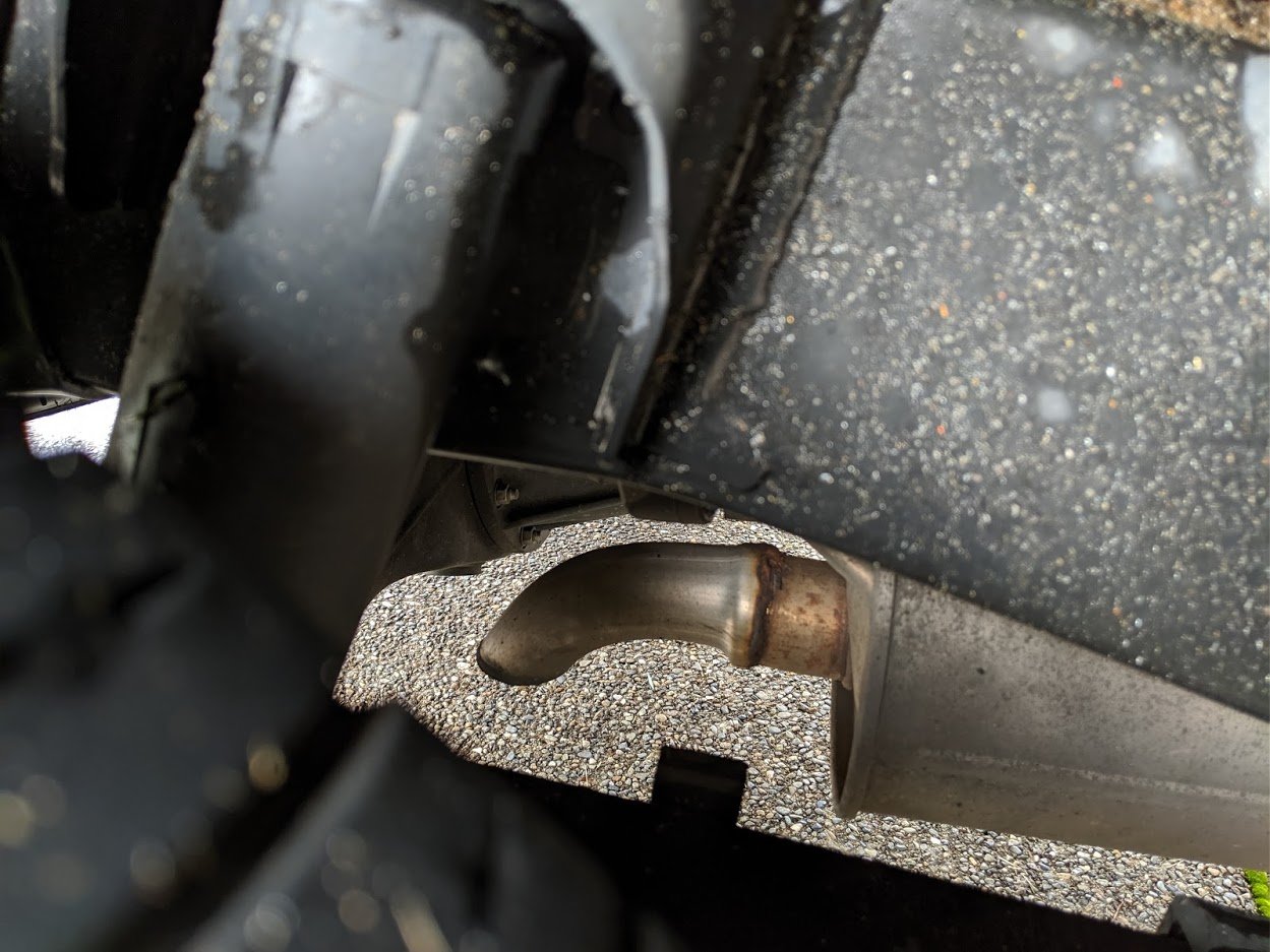

    If you are going to wheel it, a lot of folks like an axle dump. That gave me some extra clearence and some free sound:

    Chopping the tail pipe either before or after the axle. The after axle is free and easy. :sawzall: :sawzall: :sawzall: No more tip polishing. :rofl:
    The pre-axle dump, like my pic, needs a short, down-turn tip. :welder: :welder: :welder: You can use one of the bends from the cut section and just get it expanded. I failed there, as did the Harbor Freight expander. The OE pipe wall was too thick for it.
    I like the pre-axle for removing some weight and ease down the road if I mess with the muffler.

    So from your picture, I assuming you just run a larger intake pipe from the air box to the throttle body? If so, did you buy yours or make it yourself?

    Yes. It gets rid of that big resonator.
    Mine is from HPS:
    https://www.amazon.com/gp/product/B078H65713/
    Some folks have made one with the appropriate silicone elbows, a straight tube, and a connector for the vent hose.
