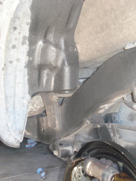

    Hi guys my truck is leaking dif oil out the back wheel i think the seal bad but im almost postive my bearings are bad if can let me know what i can do to fix this i can get my yota running safe again

    Pull and replace the axle seal, replace the axle bearing if worn.

    One of my wheel wells looked like that on my old car and it turned out to be brake fluid from a busted caliper.
