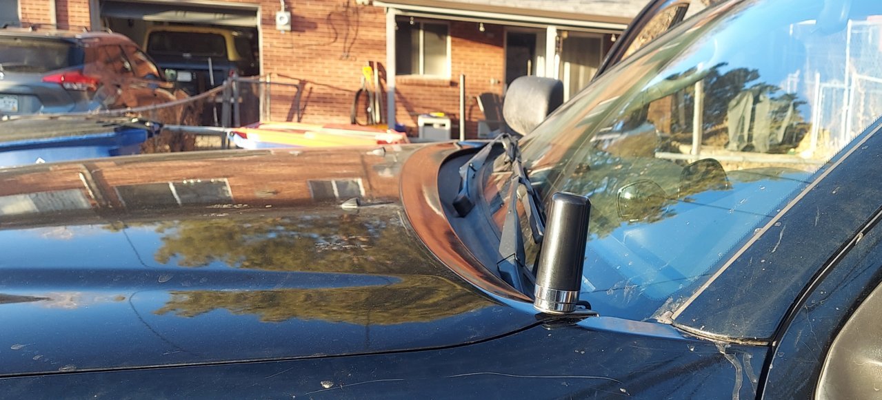

  10. Apr 12, 2022 at 10:38 AM
    CenCal805
    CenCal805 Well-Known Member
    Dec 29, 2015
    #173422
    536
    California
    2016 Tacoma TRD OR AC
    Found this on the Midland site on one of the pictures for the
    MICROMOBILE® MXTA24 LOW PROFILE ANTENNA CABLE:
    but can't seem to find it on their site. I'm looking for a mount like this. Should I be looking for ditch light brackets? Anyone know where I might find this?
