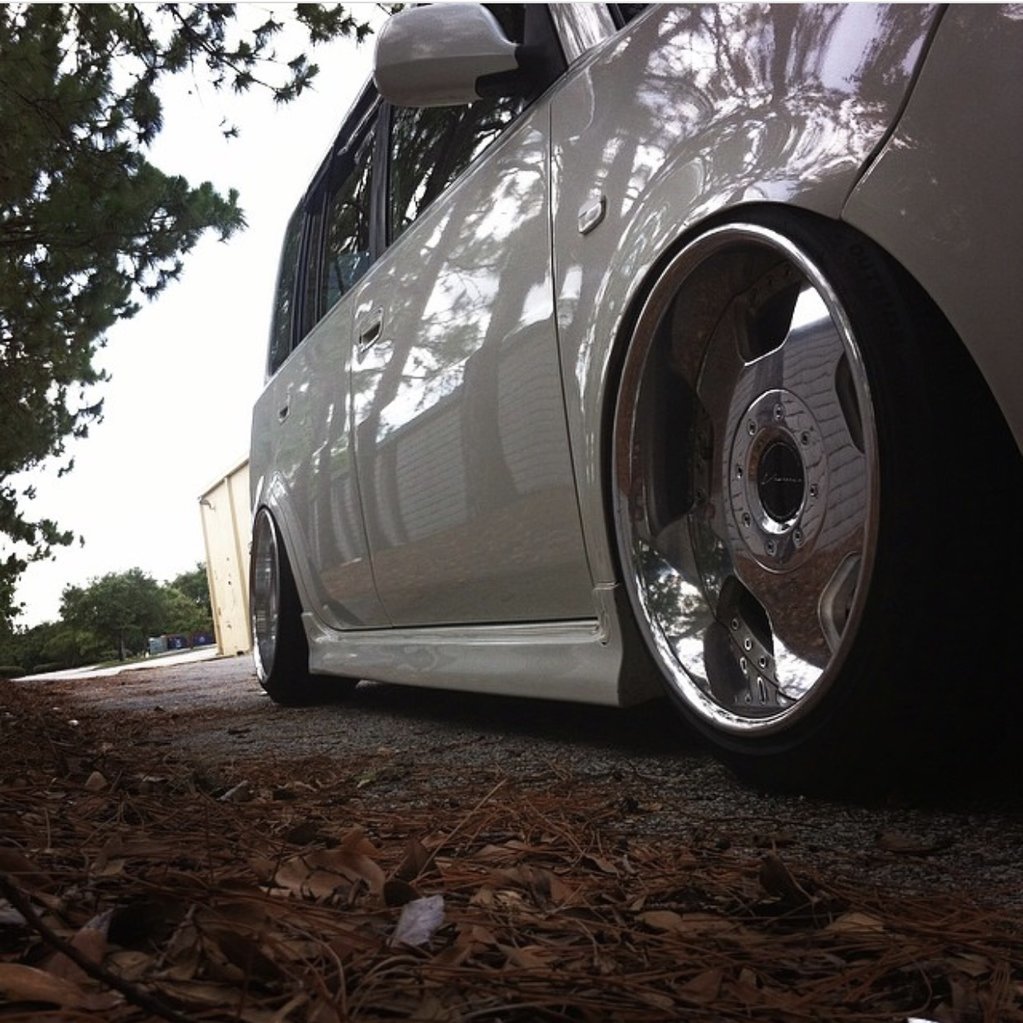

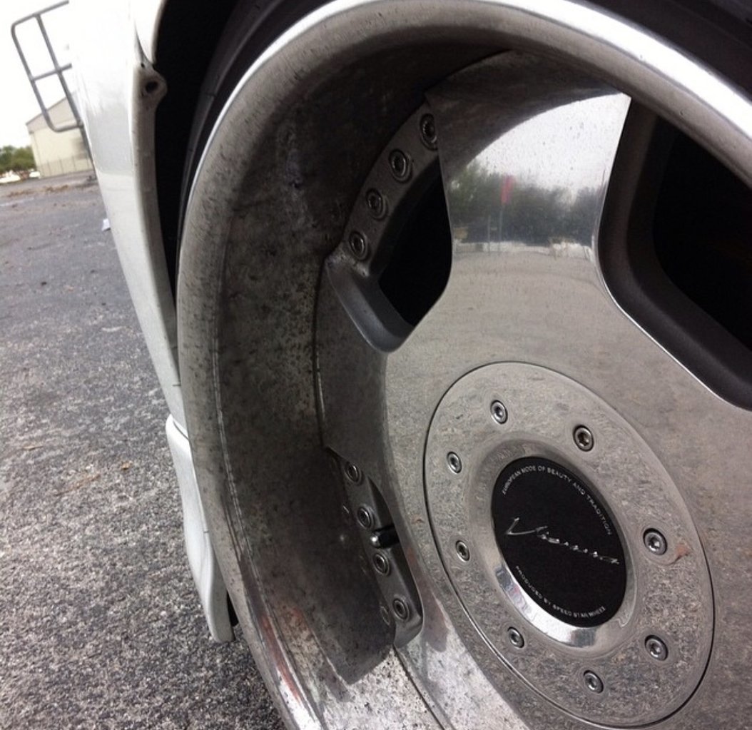

    I had ebc green stuff pads on my last vehicle because they claimed they give off 70% less brake dust than oem pads. Infact they gave off 50% more dust.next time I'll go a different route when the time comes for new pads.

    Clean wheels compared to running green stuff ebc pads for 1 week.

    +1 on that
