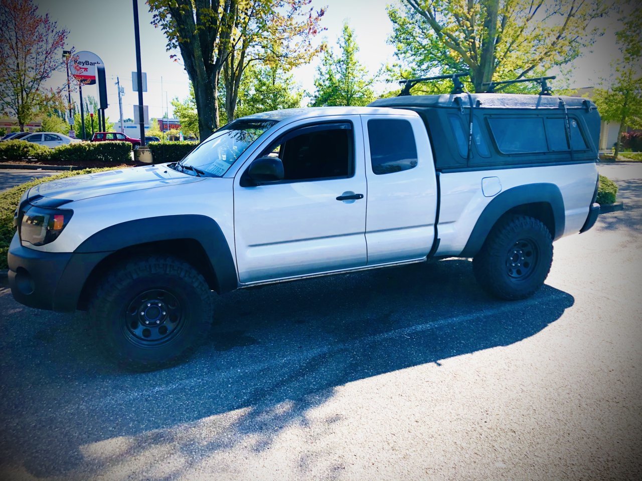

    47863F0E-860A-4824-9FB7-4F6CE2A44B73.jpg Hello everyone.
    I’m currently running stock suspension with 32” Nitto trail grapplers. I’m in the market for a new suspension. This is my daily/weekend warrior. I am a novice when it comes to research. I know rough country is the best bang for your buck so I’m leaning towards the 850$ 3” suspension but am worried about longevity and also like the idea of being able to have my suspension rebuilt if need be. So I am also looking at icon stage 3 or possibly a king setup. If there’s a cheaper way to piece together the same quality setup I’d also go that route i just have no idea. I also love the 35” tire set ups some guys have so I think I’m going towards that in the future. If some bored people could send me their opinions and thoughts that’d be much appreciated thanks!! -LeviB.

    yeah that’s what I’ve been thinking lately, to go with the higher quality option especially if I end up running 35s. Not sure if you’ve researched much but I’ve seen some guys kind of piece together their suspension and some just run icon or fox. What have you found to be the best in your opinion?

    Based on my research it seems the Bilstein 6112/5160 combo is about the best middle ground. More $ than the entry level stuff but very worth it for the added performance. And much cheaper than the high end stuff without being thaaaat much less performance. Unfortunately, that setup seems to be backordered everywhere so not sure how soon you could get a set. I have the TRD Pro Bilstein setup, which is very close to the 6112/5160 and I love it.
    Then just pair that suspension with a good AAL or full leaf pack based on what your budget and needs are - mainly how much weight you plan to carry and how much lift you need. New bump stops would also be a great idea and if you with around 3" lift a new set of UCA's could be good. I'd look into the SPC's (or better yet the cheaper Mevotech which are exactly the same).
    I'd also look at the Eibach kit if you're looking for the cheaper setups. Or the 3rd gen Fox TRD pro suspension. Although the Pro suspension isn't height adjustable if that's important to you.
    As for the 35's... making that jump will be more about the correct wheel fitment and trimming stuff to get them to fit rather than adding more lift.

    Awesome info man much appreciated!! You just saved me lots of research time. But yeah I’m still not set on 35”, will do 33s first and go from there.
    yeah I think I’ve narrowed it down to either the 6612/5160+AAL&UCAs or just going with an icon stage 3 or 4. It’s looking like with those Bilsteins with OME
    AALs & UCAs it’s about $2200, not sure what bump stops to be looking for (again I’m a noob). Then the Icon stage 3 is $2900 and stage 4 is $3300 both without bump stops so I’m not sure what that will add onto the total price. So I guess, anyone have bump stop recommendations with either of these setups?
    Edit: Which ever setup I go with I’ll run 33s at first then decide later down the road if I want to go the 35s route. Any gear changes needed after the lift and 33s?

    so with the dobinson it looks like about $4700 I’m just wondering how much better performance that’ll get me than the icon stage 3 or 4 which is about $1000 less.
