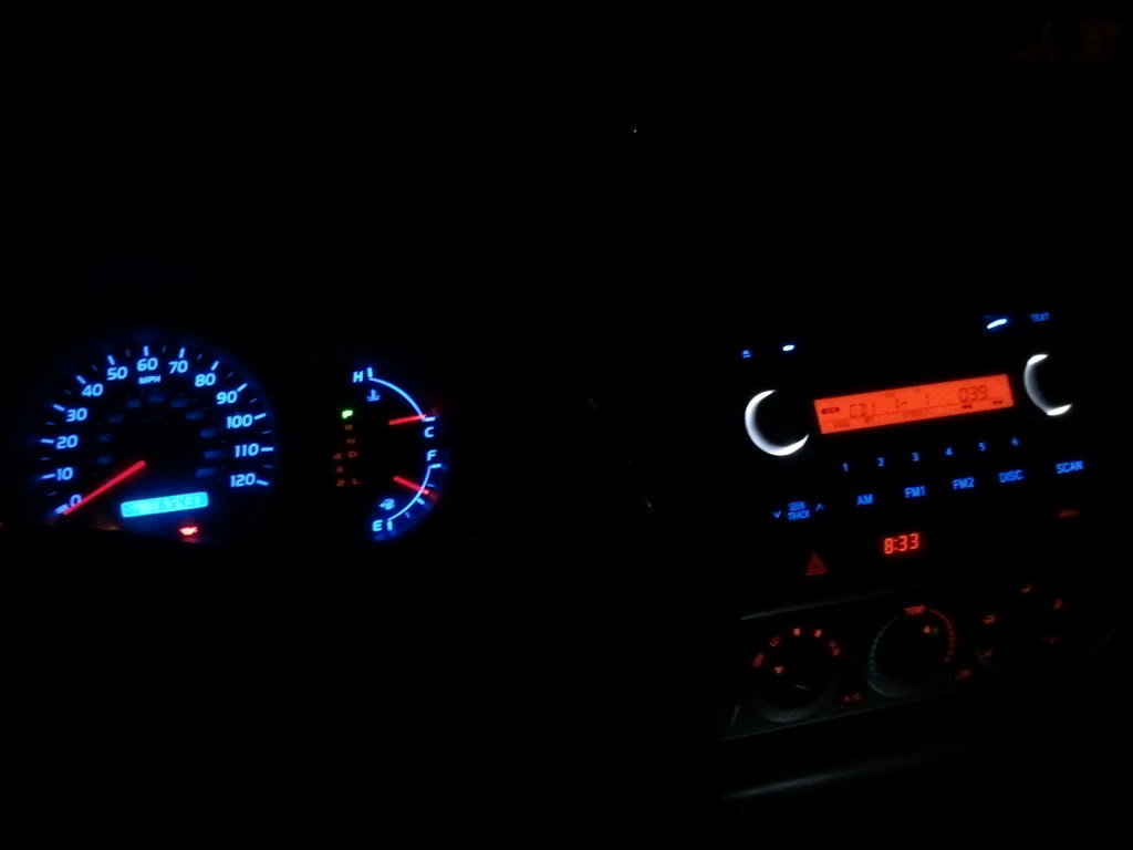

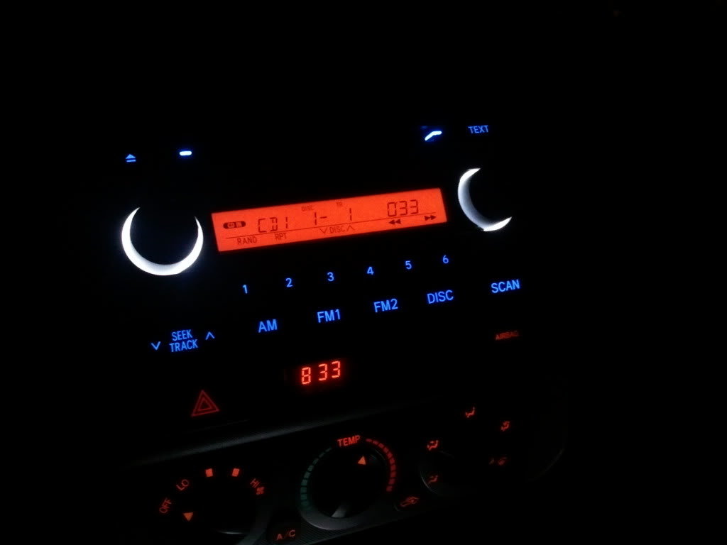

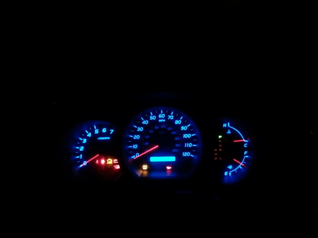

    I didn't pull my dash apart that much man. Its pretty simple to do the led swap tho. The leds for the dash aren't that small, u should c the ones for the stereo. Those r the ones that r SMALL.
    Here is a pic of mine.

    of course it possible that's mine in the picture :D
