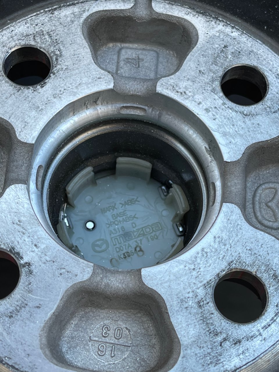

    I know, I know...this is not a Tacoma. Just a few weeks ago I gave my '08 Tacoma to my daughter (hit 100k on the drive from CO to CA) so I'm figuring this will be my last post for a while since I now have an '05 Mini Cooper S.

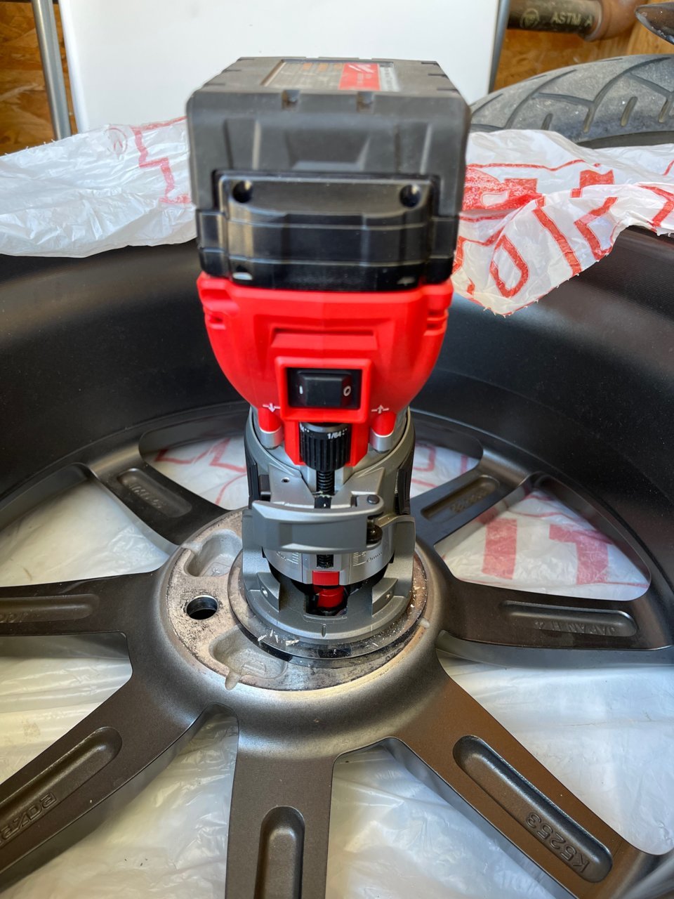

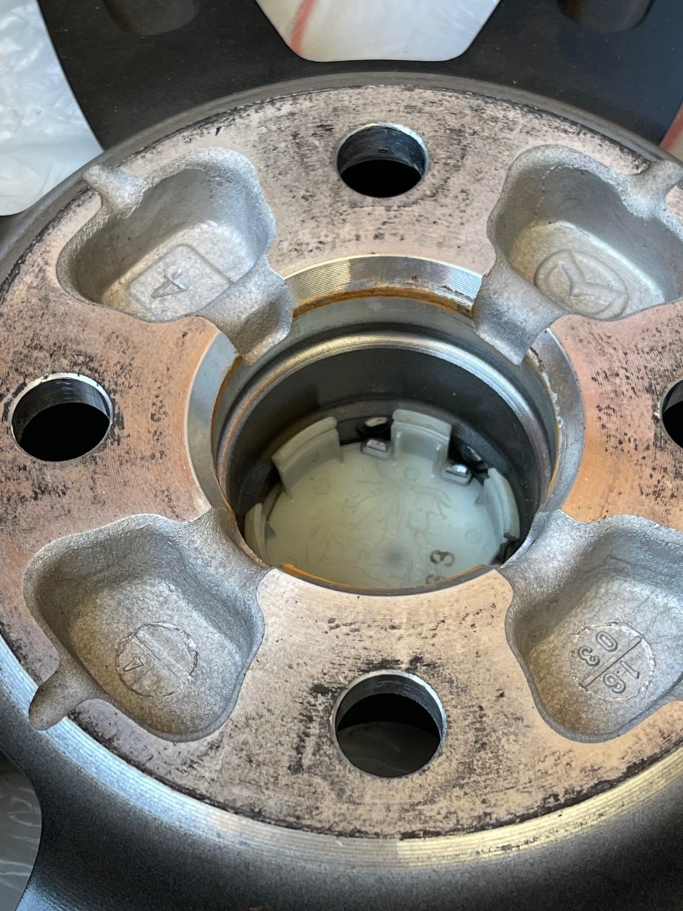

    I wanted to thank OP for the instructions as it saved me since I did not pay attention to the center bore when I picked up some used Miata wheels and used this method to widen the bore the needed 4mm.
    I just went to HD and bought a rabbiting bit from the router section, nothing special since aluminum is soft and this bit went through it like butter. I just went slow but with the little amount I was taking off, it wasn't a big deal.
    Before
    Handled Mill (aka router)
    After
    Before & After
