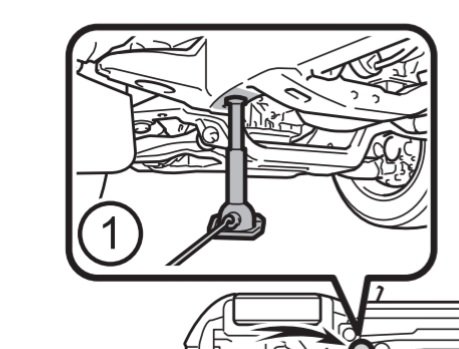

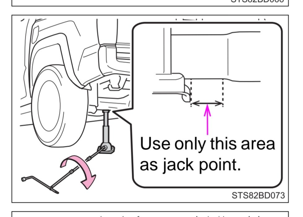

    A stock jack will lift a wheel off the ground easily even with a lift.
    The stock rear jacking location is on the diff tube inside the u-bolt plate. So unless you have 44" I am confident you can lift the rear.

    The front will be a little higher but that is easily overcome with a solid 3 or 4" block of wood.

    Why carry more than you need...
