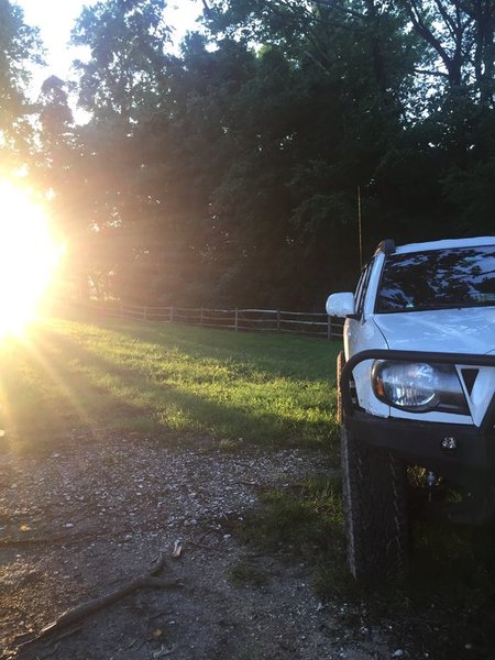

    Started with a 2010 DCLB TRD Sport Prerunner
    In Dec 2014, sold the Prerunner and moved to the current build. First look after picking it up.
    Promptly removed the Westin brush guard.
    Weeks went by and installed OME 886's and 5100's, rear Deaver AAL, 285/70/17 Hankook MT's along with the PelfreyBilt. Didn't take pics of the install but managed to get some pics afterwards.
    Then came the time for 35's.
    That's all for now. :D

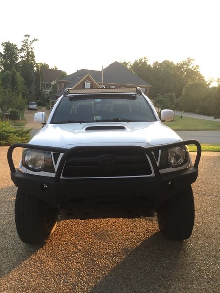

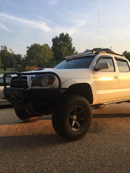

    Roof rack light bar mounting:
    Had to fab up custom mounts to the roof rack using 5/16" bolts, lock washers, and nylock nuts. Ran the 12 gauge wiring down the windshield and put a bead of black silicone to seal it in and retain a clean look. This SOB is bright as all get out. There's a good bit of glare on the hood but looking into making a fairing to reduce that. Fused to the Blue sea with a 30A fuse and relay.

    Spacer lift, bumper stickers, ejector seat, etc.
    Had to fab up custom mounts to the roof rack using 5/16" bolts, lock washers, and nylock nuts. Ran the wiring down the windshield and put a bead of black silicone to seal it in and make it look clean. This SOB is bright as all get out. There's a good bit of glare on the hood but looking into making a fairing to reduce that.

    2013 4x4 DCLB Mag. Grey
    I ordered a 40" bar and am planning on installing it pretty much the same. Have been told there is bad glare from the hood? Just wondering if you get this glare?
  16. Aug 6, 2015 at 4:27 PM
    #16
    Jake Go
    Jake Go Well-Known Member
    May 22, 2015
    #155833
    75
    Jake
    Vancouver, Canada
    Haha. I guess you answered my question above. Is the glare baad?
  17. Aug 6, 2015 at 4:33 PM
    #17
    Incognito
    Incognito [OP] No better friend, no worse enemy
    May 25, 2009
    #17626
    13,751
    VA
    2012 Pyrite AC TRD OR
    On a light colored truck like mine, the glare is pretty intense. I think with a fairing of some sort it wouldn't be so bad. With magnetic grey I don't think it'll be nearly as much of an issue than on white though.
