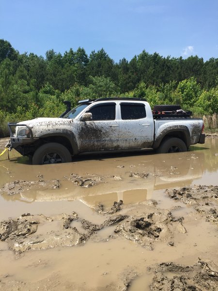

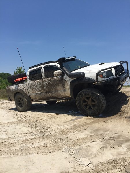

    Update:

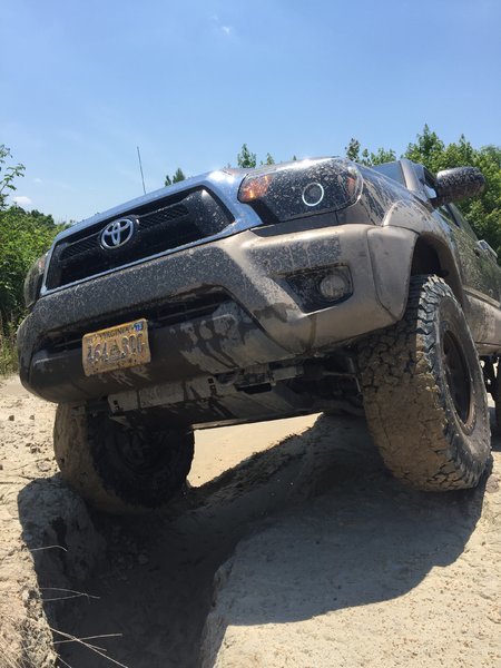

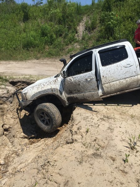

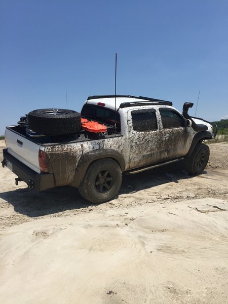

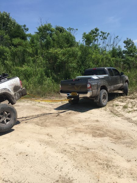

    Went on a trail ride a few weekends ago with Incognito V2.0's owner, @granstaco, and had a blast. Got to really test out A-TRAC and the rear elocker for the first time and was extremely impressed.
    :eek: Took quite a bit of persuasion to get it back on flat ground but we managed. Good example of why wheeling alone not the best idea.
    Just a little stuck....
    Budbuilt IFS/mid skids. Saved my ass a couple times.
    Little bit of flex with the AP standard pack.

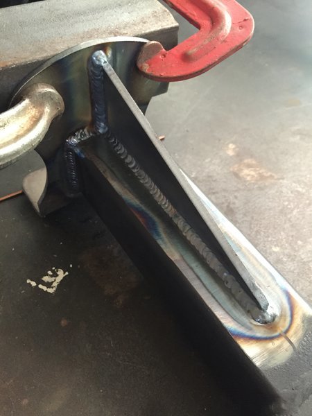

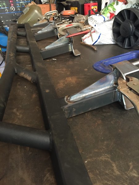

    Next up is a set of BAMF weld-on sliders that will be getting installed this weekend. Know someone with lots of welding experience who laid down some incredible TIG welds for the gussets/frame plates. Always happy to see stacks of nickels like this. :D

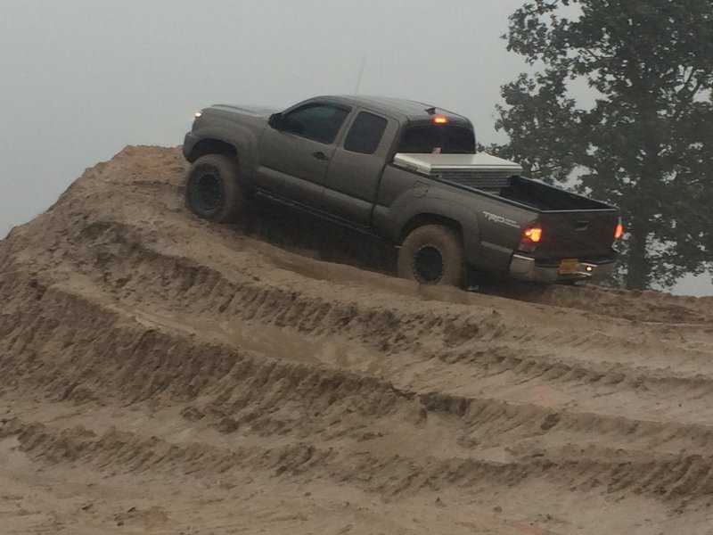

    Here's a few pics of the truck during Hurricane Matthew giving ATRAC and the elocker a workout -

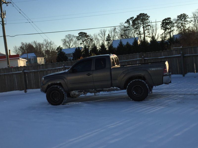

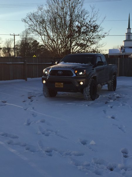

    Also got the opportunity to get some mall-rated flexing during a fluke snowstorm earlier this year. Parking lots stand no chance against Incognito V3.0. :D

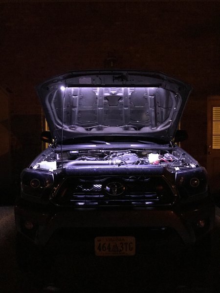

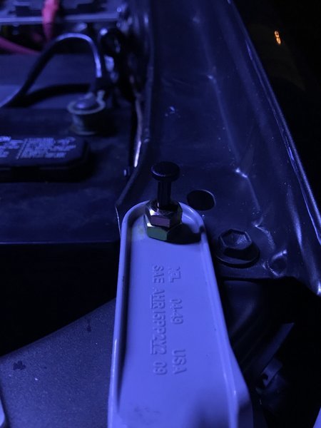

    Underhood LED strip lighting -
    Added underhood lighting using LED strips from Amazon. Soldered the strip lighting to 16ga wire, then routed them to a pin switch via @tacozord's method to make it a clean install. Pin switch activates the lights when the hood is open and turns them off when the hood is closed, much like the lights in your refrigerator. Awesome cheap mod that is incredibly useful, much easier than having to rig up a work light to do anything in the engine bay.
    LED strip lighting
    Pin switch
    1/4" braided wire sleeving
    Zip tie mounts
    Heat shrink
    Zip ties
    Misc. wire connectors
