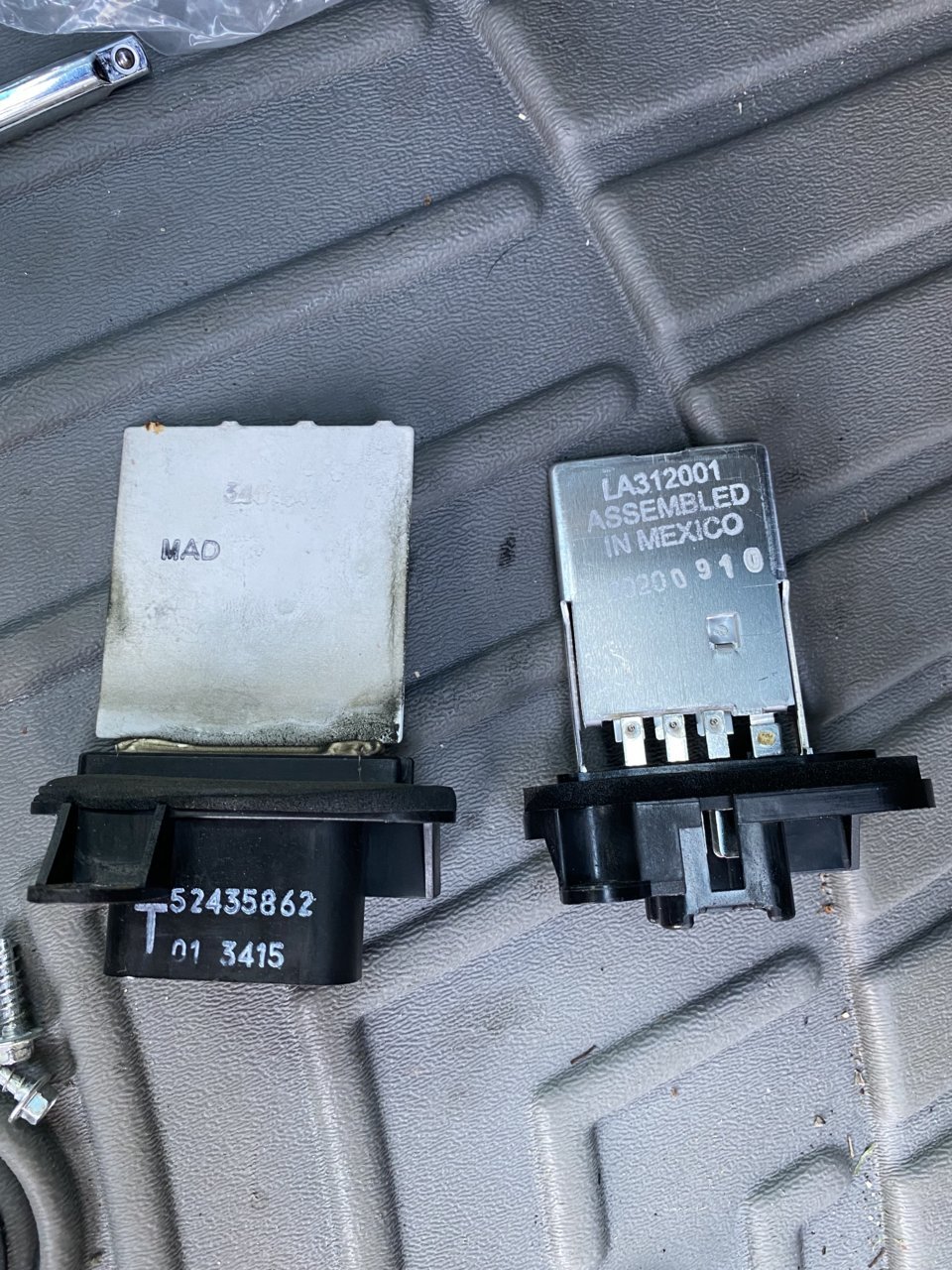

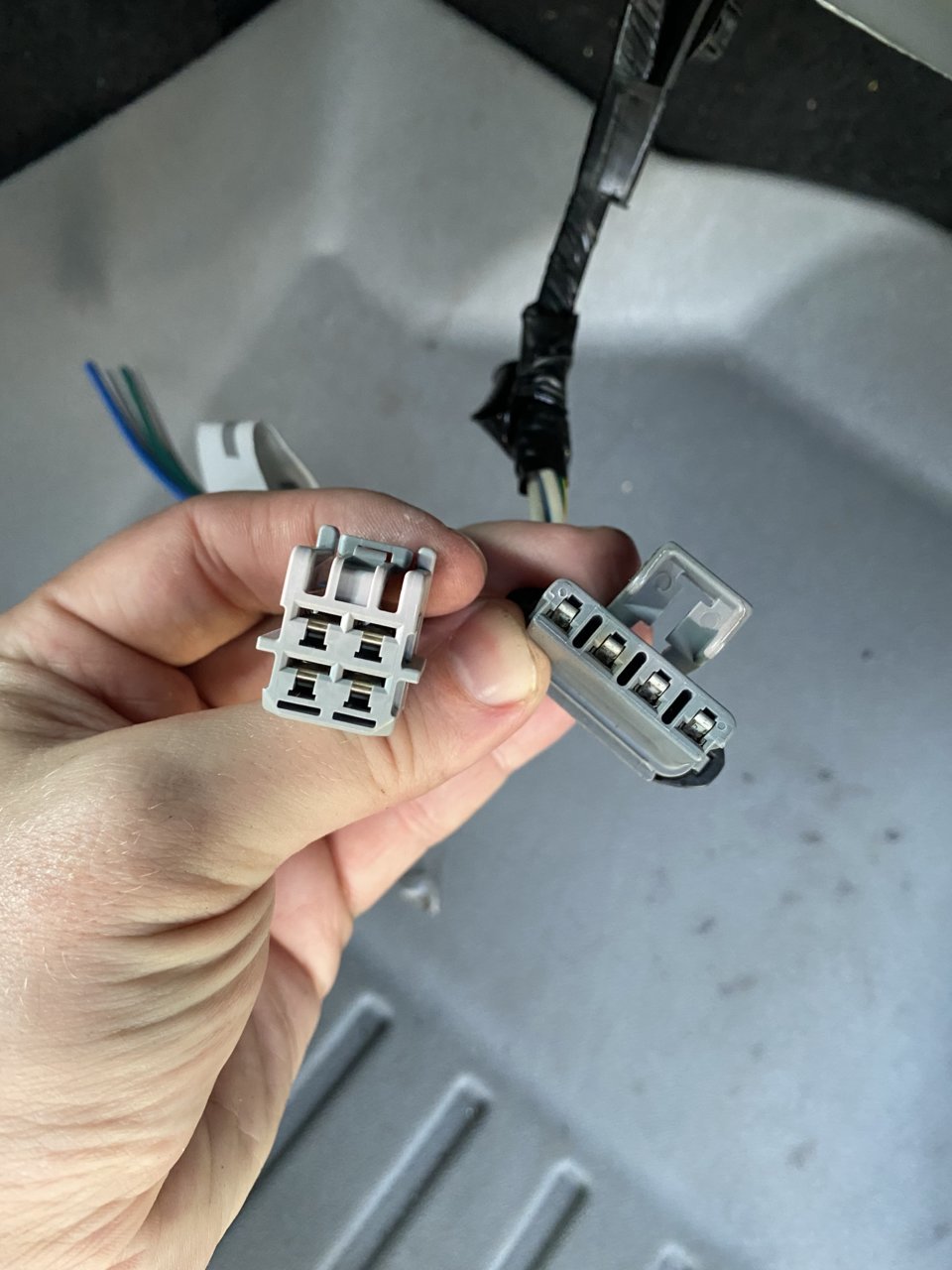

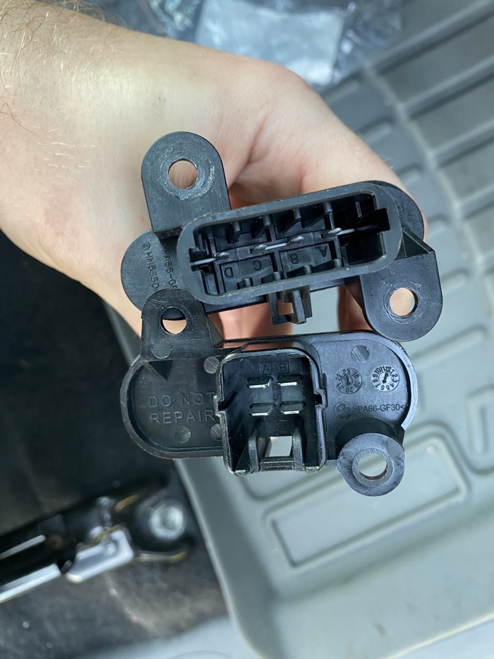

    Just wanted to give an update for future researchers.
    Today I replaced the resistor and the pigtail with the updated design. Part numbers 87138-04070 and 82141-04Q80. I wasn’t expecting the new to look so much different than the old, but it does.
    Everything is working great right now. The old resistor looked pretty rough but the connector looked fine. It seems like the air flow is stronger on every speed than it was before, but that could be wishful thinking. I’ll give it some time before I consider it solved, but if is, we’ll know that a bad resistor can cause weak air flow and not just NO air flow.
