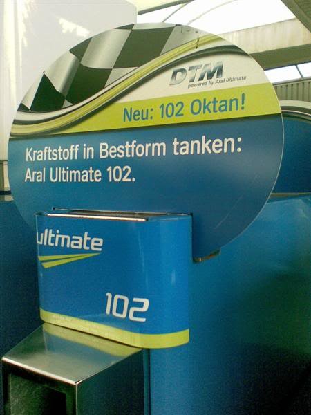

    Hah! Stock sucks. Fwiw, I ran several tanks of 100 octane (on the Autobahn in Germany and VP race fuel at the pump in Barstow) and it really likes that stuff.

    100 octane in Germany is equivalent to 95 octane stateside. They use RON, whereas in the us we use an average of the RON and MON measurements. Perhaps they use less ethanol, I can't recall.

    I don't think there was any ethanol in the Autobahn 100 at Aral, could be wrong. Either way, it ran better on it than "regular".
