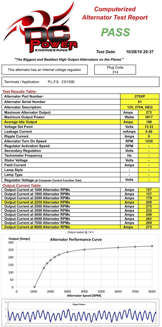

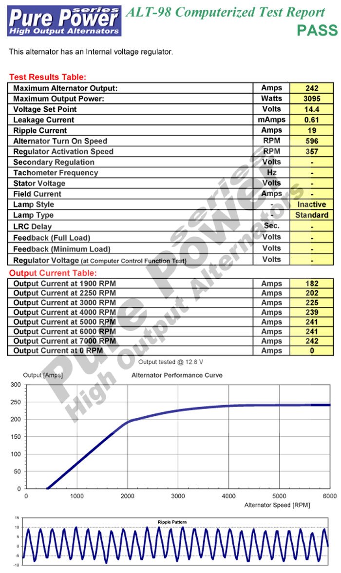

    Looks like the DCPower alt. doesn't even turn on until 1230rpm
    Pure Power/TAE might make one for the 3rd Gen that turns on a lower RPMs (596 RPM for the 2nd Gen)

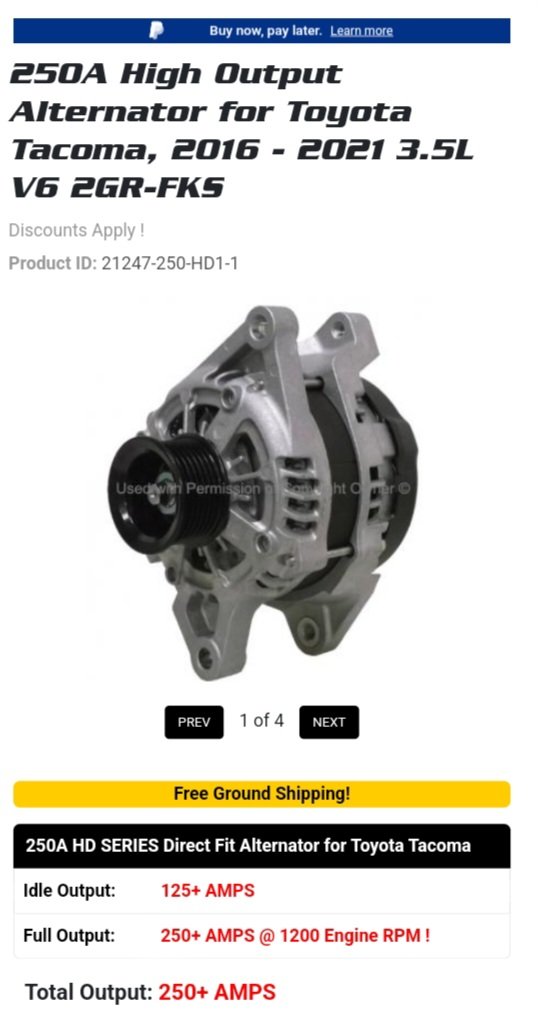

    PowerBastard claims 125 amps @ idle and 250 amps @ 1200 RPMs

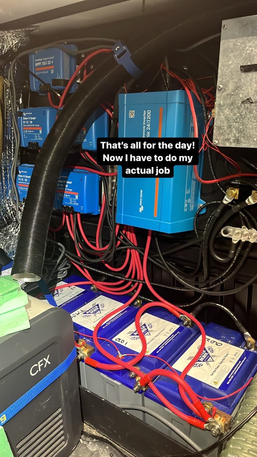

    We are talking about house batteries here. I live in my Tacoma. I have 4x 100Ah battle born batteries and am trying to run 4x Victron Orion 30A 12V to 12V to keep the bank charged. I’m running big loads like a high performance Starlink dish and I’m cooking with electricity on induction.

    All of my wiring from the front to the back is 1/0. Splits off into all the chargers on a bus bar. Here’s a pic of it. Wire is quality but I did this on the road so wire management is not the best.

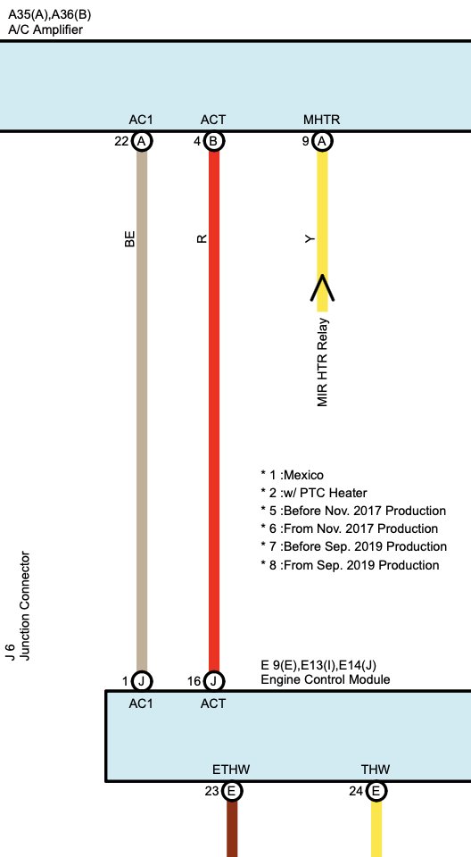

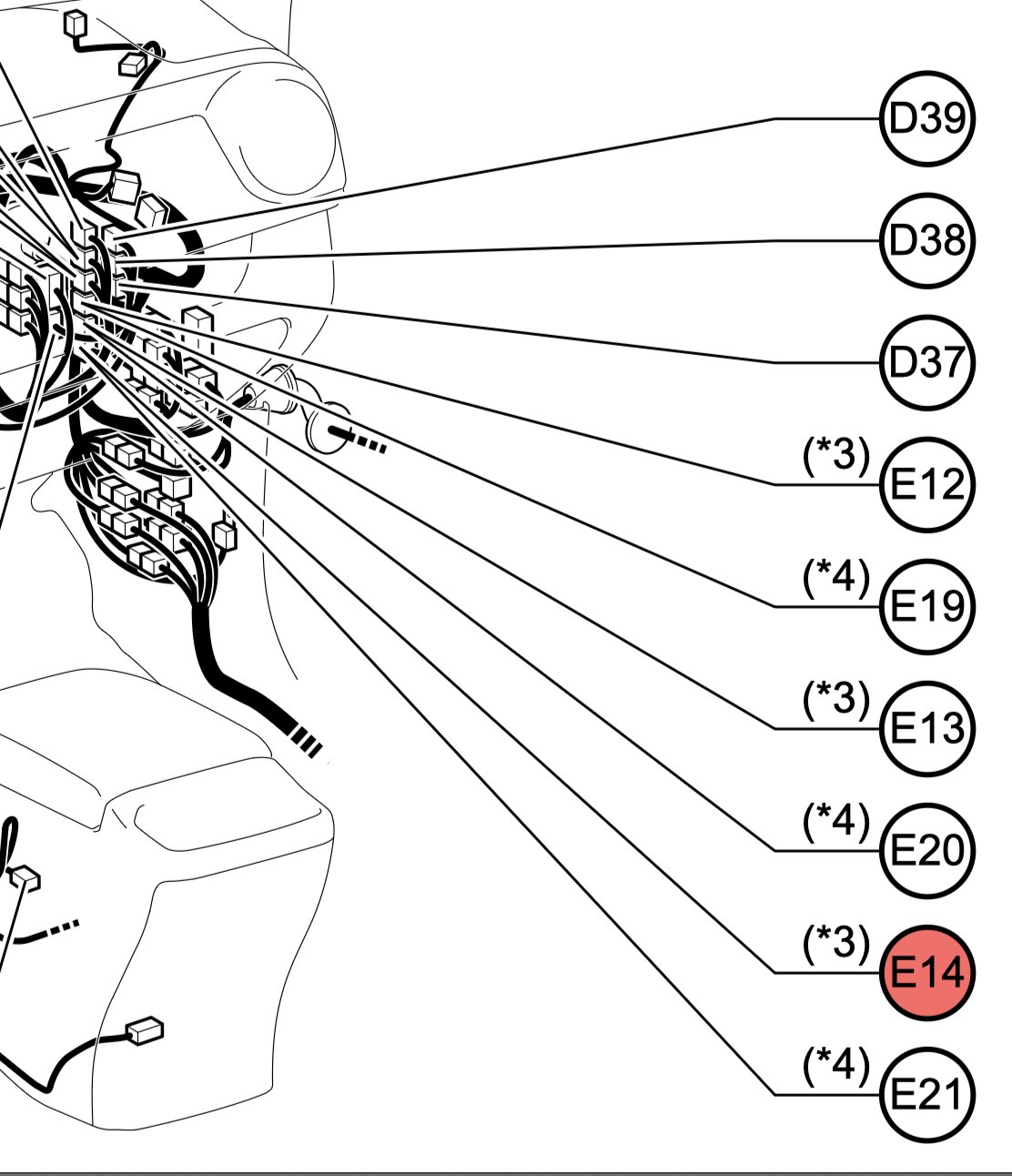

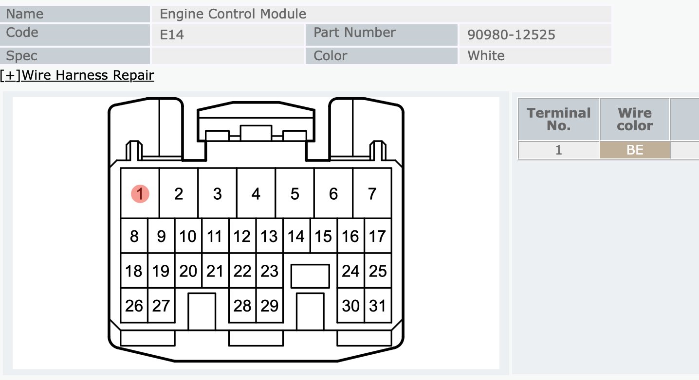

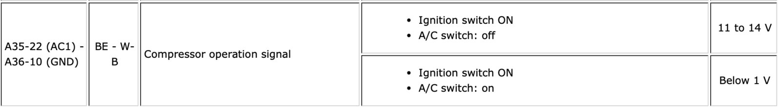

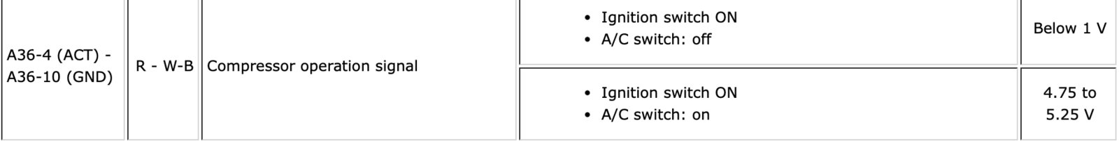

    I can't take no for an answer... so I figured it out with some help from TIS
    AC1 is a signal to the ECU to tell it the air compressor is running for the AC. ACT is the feedback signal from the engine. If you ground AC1, the engine speeds up to about 900 rpm (just looking at the gauge) and the truck won't let the speed go under 750rpm even with all of my extra loads on.
    I believe the AC1 signal is an open collector output from the AC amplifier ECU. I ran a 120 ohm resistor to ground just in case.
    I haven't done the permanent wire modification yet, I was just sticking a resistor in the back side of the connectors. I'll post pics when I finish the mod. I plan to put a switch that controls 2/4 of my chargers plus this.

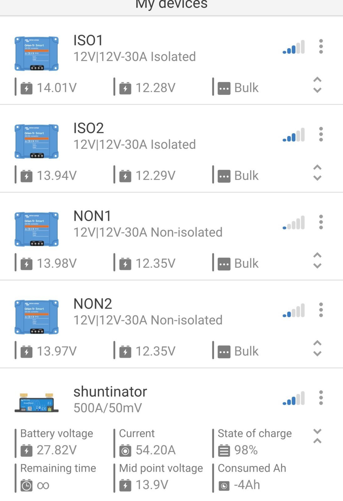

    My Victron dashboard, for anyone interested:
