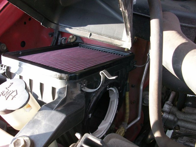

    Here it is...I was able to fit a 4" deck plate on my 2.7...I got the K&N filter too. Just waiting for the silicone to dry then Im taking it for a test drive!

    Wow...the acceleration feels a bit quicker and smoother..nothing dramatic but i can feel I have to brake more (prob cause I'm going faster!) At first my check engine light turned on (is this normal?) it went away and has not come back so far...

    Sometimes the light comes on. Just keep an eye to make sure it doesnt come on again.

    All mental. You may get more air into that engine but you won't get out more then 3-4 hp and none of them bellow 2500 rpm. Your light will come ON again. Specially if you do any high altitude.

    A 4" gave my 2.7 6 more hp. 2 about 3000, and it ramped up from there. I definatley felt it.
