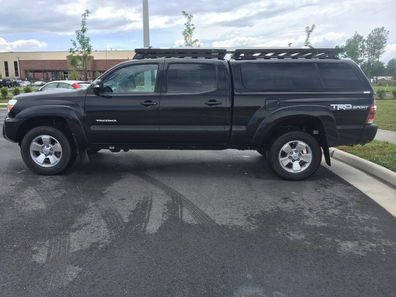

    I am a contractor and installed the following items on stock suspension to expand the use of my '15 Tacoma DCLB 4x4.
    TruckVault 180 lbs
    Bedslide 200 lbs
    Camper Shell 180 lbs
    Roof rack 60 lbs
    Cargo 100lbs constant and occasionally more depends on the day
    Total 720lbs + or -
    After install, I have noticed the rear suspension seems to be a bit stressed. The rear is slightly lower than the front and rear bottoms out on smaller bumps. This presents an issue because I am constantly carrying roughly half the weight of the trucks maximum payload capacity and any additional load only worsens the ride quality/safety/lifespan of stock suspension.

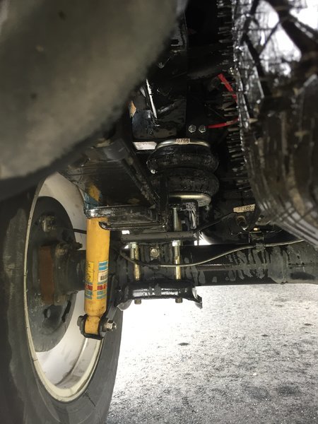

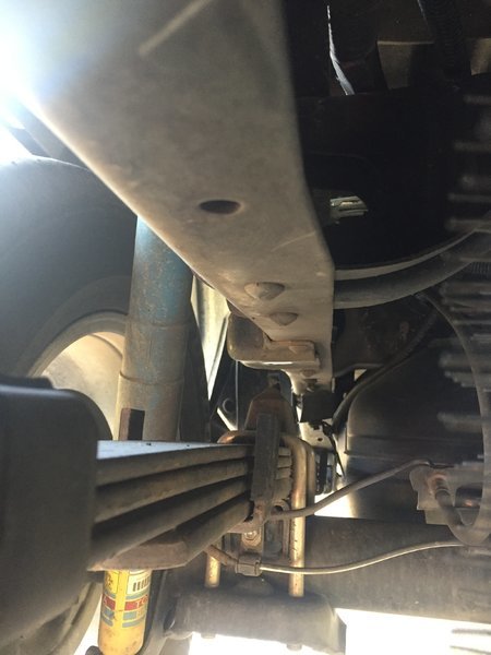

    IMG_2189.jpg IMG_2188.jpg Installed the Ride Rite Air Bags and the issue is solved.
    No more bottoming out and my stock rake is back.
