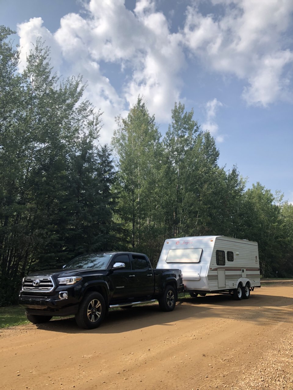

    I have a stock 2016 Tacoma with 265/70/17 cooper AT3 4S tires right now in the 115 load index. In the summer I do sometimes pull a 21ft jayco camping trailer. Do you think I should be increasing tire PSI for the heavier load? 35 PSI instead of the usual 30-32?

    Yes.
    Tow safe.

    probably, but best way to tell if you need to make an adjustment is to do a chalk test with the trailer in tow
    https://www.tacomaworld.com/threads...at-psi-to-run-for-your-specific-truck.445639/

    The ability to tow more weight increases as your tire pressure increases as well. Granted you don't want to exceed maximum tow weight rating per tire and pressure of the tire that the tire is rated to otherwise you risk having a nasty blowout.

    Your tire's load capacity will not increase above 36 psi.
    Anything between 36 psi and the tire's max psi is used to meet the speed rating.
    Stock load inflation is 2,149 lbs.
    At 30 psi, your tire has a load capacity of 2,326 lbs.
    At 36 psi, your tire has a load capacity of 2,679 lbs.
