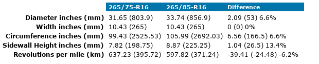

    I was looking to push the tire out from the wheel wells for a more aggressive look. If i stayed with the 265 but went up on the sidewall number to 85's would that add a 1/2" approx. in ground clearance? The tire calculator indicates that it would, does that make sense? I am interested in lifting it down the road, maybe next summer.

  9. Oct 26, 2013 at 11:32 AM

    Are you sure they make a 265/85? I'm sure it would be a good popular size

    No such size that I've seen...

    yeah that size doesn't exist
