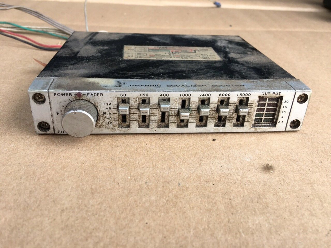

    BAM! Toss this joker in and call it a day. Nothing says bad ass like a booster/eq.

    Sheez, did ya pull that out of a tractor or catch it with a fishin pole?
