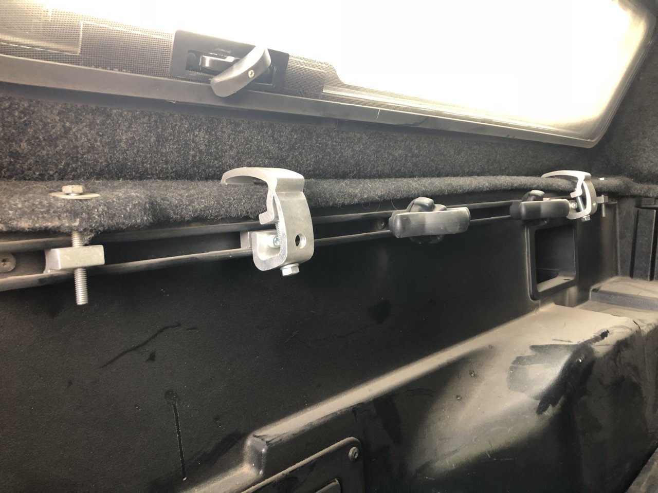

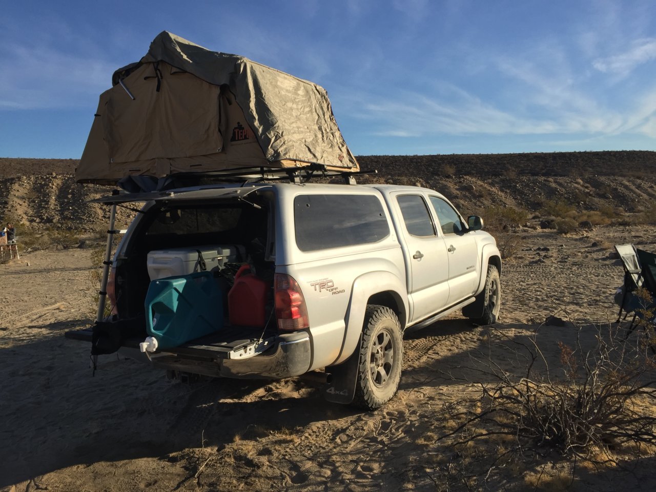

    I have a leer 100xq on my 05. Its a good shell. Have a thule towers on rails with a 2 person 95 lb rtt no problems. i did reinforce the clamping power to the bed rails. The first time i drove around with the rtt on the shell, i noticed the shell moved back a little on the bed. More likely just needed to tighten the standard clamps but went ahead and got extra clamps anyway.

    Good info! Thanks for the pics as well!
