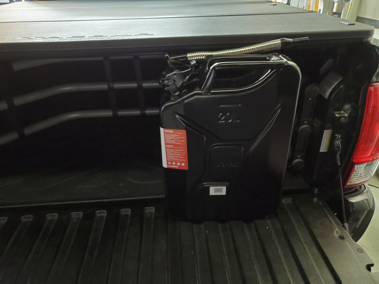

    The CARB spouts suck balls. You have to press the tip of the spout hard to open the release valve to allow the fuel to pour out. The release spout is tightly sprung so there is a problem if you are trying to pour fuel into a plastic gas tank (my generator and lawn mower) or a large opening (my pressure washer). I assume a vehicle would be just as difficult if not more. You literally need three hands to pour fuel!
    Easy but not cheap solution is the flex spout (shown in the pic). None of that CARB crap, it's vented to avoid "glugs" and it pours like it was 2008. However, it'll cost ya! That gas can in the pic was $100.
    Shellshock and Phich like this.
  12. Oct 5, 2020 at 1:59 AM
    #52
    Phich
    Phich Porkchop Express
    Feb 17, 2017
    #210855
    964
    San Antonio
    2017 TRD Off Road tuned to KDMax perfection
    Six Demon Bag
    CARB spouts are the worst thing to have happened to fuel containers since there weren’t fuel containers.
    I rip the damn things right off and deal with a shorter spout.
    While I don’t own one, it’s obvious that flex spouts are worth every penny even if you’re using your fuel cans only once a year.
    Fact.

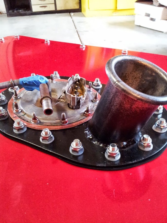

    2000prerunner23
    2000prerunner23 Well-Known Member
    Nov 29, 2018
    #274262
    906
    steve
    Buy or fabricate the desired fuel cell volume and just adapt the stock pump, and emissions crap to the fuel cell via an adapter plate. That's what I did for my old ranger. 22 gal RCI fuel cell with stock pump, float (for gas fill gauge), fill neck and evap canister.
    71FPFFbXcQ5fMyQg5z1NT719UmbVJzb4dWZloJ_j_ae58225564b56004a378a1c2cd846813b23aea67.jpg
    https://www.pirate4x4.com/threads/fuel-cell-stock-pump.1120458/
    The new tank can be where the spare tire is so weight distribution is more even and not just on one side. Also no need to buy "skids" as the new fuel cell will be either full metal or metal outer layer with a bladder. Plus it's generally safer vs a stock plastic tank.
    This is the least ghetto rigged option. Not sure what all that shit is about with some jerry can in the bed. That crap looks sad and lazy. If anything is worth doing it's worth doing right.
