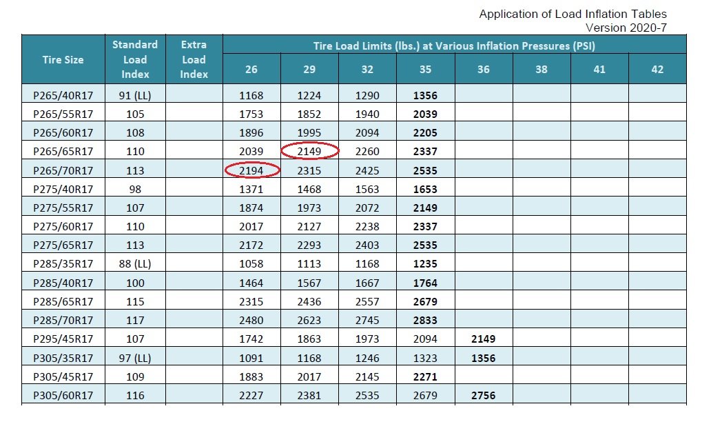

    Tire shop recommended going up a size so I now have P265/70R17.
    Do I stay at the recommended pressure for the truck at 29psi?

    OEM was a P265/65/17/110
    NEW should be a P265/70/17/113
    You can inflate to 26 psi.
    Load capacity ceases to increase at 35 psi.
    Anything over 35 psi is to maintain speed rating.

    Well dang I’m at 35 psi all around. That’s what the installers left them at.
    26psi seems LOW

    Why do you think that?
    You inferred you knew tire size might influence psi by asking the question.
    Doesn't it stand to reason a tire with increased volume and higher load rating would require less psi? Posted a chart and everything...
    Ultimately, do what you want. At least you'll be in no danger of under-inflation.

    Do you have the source for the chart so that I can review it for 16" diameter wheels?

    Thanks for the help. I’m at 35. Chart says 26. I’ll drop to 30 lol
