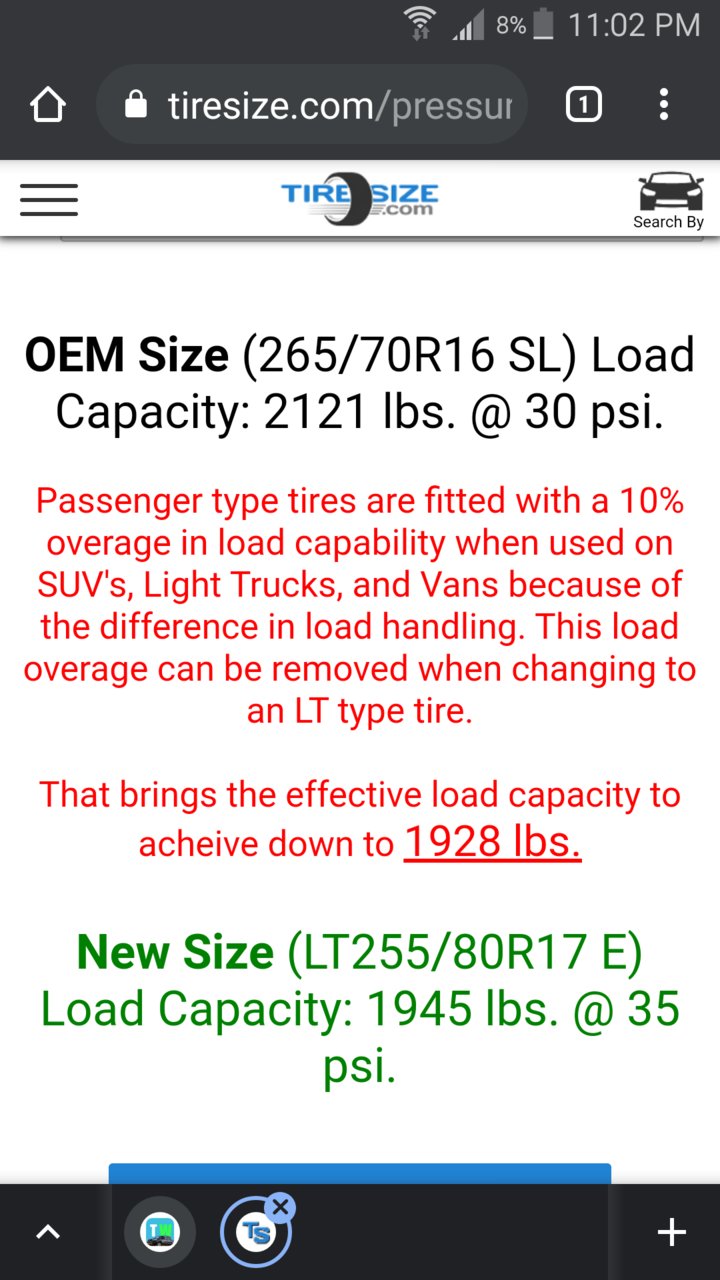

    You entered P265/70/16.
    Try again; P265/65/17/ @ 29 psi
    Thatbassguy[QUOTED] likes this.

    We're talking about @Lt. Dangle...
    You should be entering a euro-metric 265/70/16/112 @ 30 psi

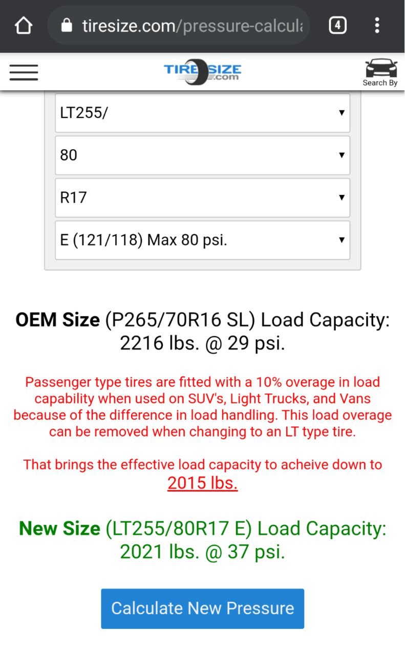

    Just ran it on the calculator provided and confirmed that the PSI I've been running ( 27 psi) for the last 2500 miles is correct.
    I believe I used this link provided a few months ago to get that 27psi pressure.
    Viewed the manufacture specs for the OEM tire and the larger tire I installed to validate the load ratings.

    @Thatbassguy
    This calculator doesn't 'round up'.
    You're supposed to inflate to or above the target weight of 1,954.
    Close enough; agreed?

    Wasn't trying to argue. I wouldn't know what Tacomas come with what tires and recommended inflation. I just put in the information I got from your post. You had circled the load rating in the 30 PSI column, so I put that in. Then, you said I should have used 29 PSI, so I did.
  16. Mar 27, 2021 at 9:21 PM
    #56
    splitbolt
    splitbolt Voodoo Witch Doctor
    Mar 7, 2010
    #32761
    7,858
    NW Arkansas
    2016 TRD OFFROAD DCSB MGM
    Just friendly banter to clarify things...
    As I said, I got OP confused with Lt.Dangle.
    In post#29, you entered a P-metric P265/70/16 @ 30 psi.
    It should have been euro-metric 265/70/16 @ 30 psi.
    You will get the same result if you input a euro-metric 265/70/16(Offroad) @ 30 psi or P-metric P265/65/17(Sport) @ 29 psi; and output an LT255/80/17.
