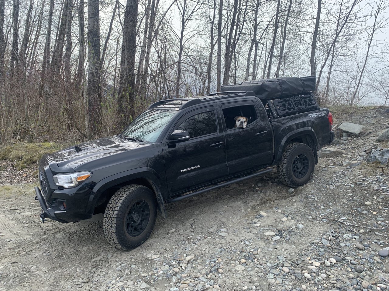

    Running my 255/80/17 E rated wildpeaks at 39 front and 37 rear.
    :notsure:
    Got about 650 of extra weight.

    When you say, "...650 of extra weight"; is that on top of curb weight or gvwr. Is it just the gear or does it include the driver?
    Your adjusted recommended psi is 36; at least you're in the ballpark.
    Junkhead[QUOTED] likes this.

    I knew you would chime in.:) I learned a lot from you regarding tire pressures.
    Not including the driver/gear, so on top of curb weight.
    80 aspect ratio seem help with a smoother ride.

    You do bring up something that may change things regarding adjusted recommended psi; increased aspect ratio. Even though you are technically over the adjusted recommended psi, the increased aspect ratio might very well warrant an increase in pressure, to deal with sidewall stability. To handle the dynamics; not so much the increase in weight.
    Just shitballin' here...
