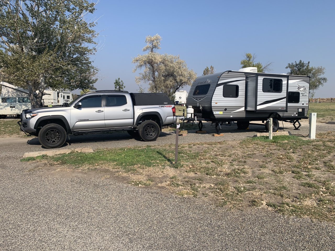

    PM me if you want to know what I did. This is 3400lbs unloaded and about 4100lbs or so loaded with water and gear

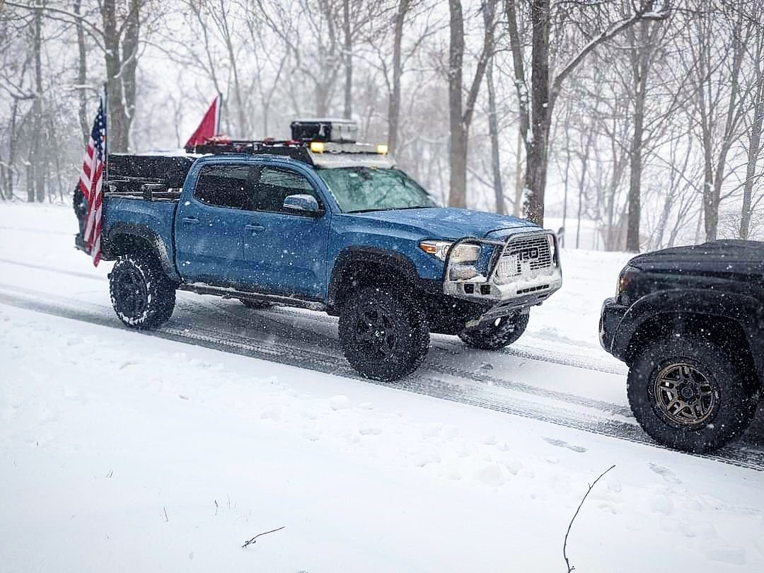

    INSTAGRAM: JWIZZMASTERWET #SUPERCHARGED #METALAF #HARAMBE PERFORMANCE/FUNCTIONAL UPGRADES: -URD Supercharger -Sound Deadened cabin with Noico Solutions 80mil -Skar Audio full pro-audio setup (2xtweeters, 4xmids, 3x10inSUB) SUSPENSION/LIFT/TIRES: -ICON Stage 4 (650lb coils) -ICON RXT Leaf Pack (Option 3), -285/65/18 BFG KO2 FUNCTIONAL(eye candy?): -Rave OffRoad roof rack -Rave OffRoad 43in light bar (amber + white) -Rigid led PODs (x4) (mounted along roof rack) -Westin Side Steps -BakFlip tri-fold tonneau cover -VOODOO Fabrications hi-rise crossbars -Pelican Case loaded with recovery gear(mounted to roof rack) -Smittybilt gen 2 overlander tent -Smittybilt recovery boards -HI-Lift Jack COSMETIC AND NON-PERFORMANCE UPGRADES: -Custom front grill -Bumper Shellz rear bumber cover -Meso Customs full interior chrome delete -Interior of cabin lined with sound deadening material (Noico Solutions 80mil) -Rear seat delete and custom shelf (home-made) AUDIO (SKAR AUDIO): -2x pro audio tweeters, 4x pro audio mids, 3x 10in subwoofers (SKAR AUDIO) -1x RP-1200 amplifier (mids), 1x RP-2000 amplifier (subs), 1x SK-400 amplifier (tweeters) (SKAR AUDIO) -Audio crossover
    I personally have the ICON RXT leaf pack at option 3 (I have a constant load of about ~500lbs over my bed, including the steel high-clearance bumper with dual swingout and full size tire and jerry cans) paired with ICON 2.0in Extended Travel shocks and DuroBump bump stops. If you had my setup WITH sumo springs or Timbren Towing Bumpstops, you should be good to go!
