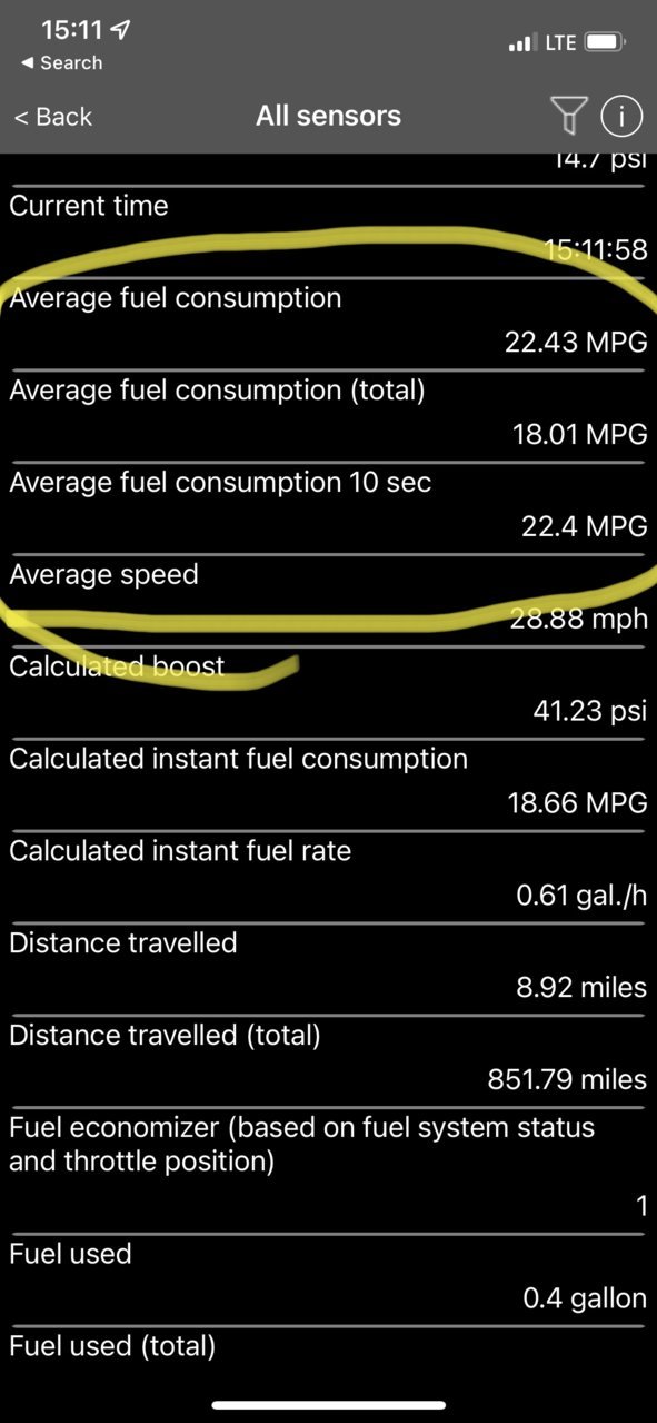

    Just wanted to share with everyone. There are a lot of aftermarket advertisements out there for products that claim to give you better gas mileage, quicker throttle response and or control, and even increased horsepower. I won’t drop any names on these products as I’ve never personally tried them myself, but I have looked into them from time to time. Anyways, long story short, for about 4hrs or my life and $81 to be exact I changed the spark plugs, did a thorough TBD cleaning, cleaned my air filter, oil and filter change. This gave me immediate throttle body response, noticeably lower TAC readings during normal driving conditions, quicker acceleration, and increased fuel economy. I went from 19mpg on a good day, to 22.43mpg. Stop and go traffic, I went from 16 to 18mpg.
    Plugs that came out had somewhere close to 100k miles on them and were still wel within tolerance 0.049. I replaced them with Denso U11’s gapped to 0.044 out the box. I cleaned the throttle body by removing it, and getting a calibrated dish sponge(new) and a microfiber cloth along with some CRC Carb Cleaner. I also got down in the intake as far as my hand could go to get a lot of gunk out of the first could inches in there. It was pretty dirty. Sorry no pics of the maintenance work, I’ll try and remember this for next time. I plan to continue to do this service at around 30k to 50k mile intervals. The truck has 192k original miles on it and I’ve proudly driven it since purchasing it with about 13k on it.

    This is funny!! 28.8mph for 8.92 miles. Really.

    Hey give me a break man, I just got the OBII bluetoothed to my phone. Also, this is my second tank of gas since doing the maintenance. Before I was getting around 320miles to a tank and the last one I got around 380 total.

    what app is that?

    Car Scanner Pro

    Good job on the maintenance:thumbsup:
    41.23 lbs of boost - WTF? :burnrubber:

    Yeah I’m not sure what the boost reading means!

    Unless you are calculating by gallons used (when refueling not just by looking at the gas gauge) to actual miles traveled, those OBD car apps are never really close, especially in short distances.

    That’s how I usually calculate it, total miles driven divided by gallons used. Not sure how accurate the OBD plug im using is, but it seems to just read data. How would I know if it’s accurate or not, in short distances? It’s constantly reading throttle body position, air flow, etc. so what would make that inaccurate? This is the first time I’ve really used this reader for what it’s worth.

    Figuring fuel mileage on 9 miles is useless. I've seen 4 mpg and 40 mpg over a 9 mile stretch. Wait until you've run a couple of tanks through it and get back with us.
