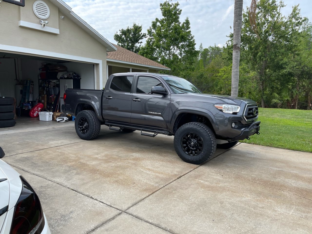

    Hi Angilolo. I asked this exact same question last week sometime and didn’t get many answers. I guess the members figure this has been discussed hundreds upon hundreds of times and you should use the search function. However when I searched the subject even though I read for hours I never really found the answers to my specific truck. I have a 2021 SR5 4x4 crew cab. It has the exact stock wheels your truck has. I did do a 3” lift in the front and 2” in the back. I put on Toyo P285/70R17 117T (these are 33”) tires onto 17x9 Fuel Vapor -12 wheels. Looks sick IMHO. However I did just discover I have rub on the front drivers side when turning the wheel half way to the left. I was going to start a thread asking about it but I figured I wouldn’t get any response other than “use the search engine”. I will probably have to remove some material. However it really isn’t that bad. Not unless the wheel is being pushed up into the wheel well because I’m running over something. Either way it doesn’t really damage anything it just makes noise. Below is a picture of the truck. I hope this helps. You’re welcome to ask me questions and I’ll be glad to take pictures and help you anyway I can. 486EA042-B4FD-41F0-AD4F-59799E0A39BE.jpg

    Thanks for the insight. Your truck looks sick for sure. Tires are badass. I'm psyched for how mine will look. I kinda decided to not bother with trying to get 33s on mine. Thinking of goin with 265/75r16s, so like a 31.6 inch. That way I can just throw those on my stock wheels and save a little money. Maybe try 33s with new rims sometime in the future. Was also thinking of getting the Rough Country 3.5 suspension lift, since it seems to be a pretty decent lift for a good deal. Thanks for offering your help.
