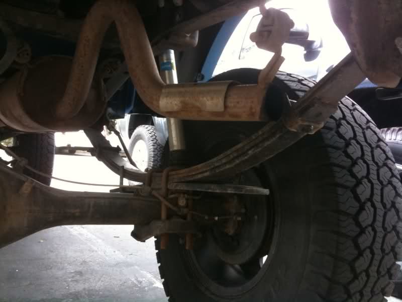

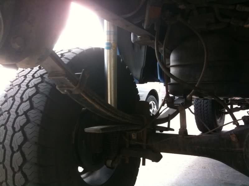

    I was in the same boat as you are but i have the 6" fabtech. I ended up converting the top mount in the rear into a eye mount, putting in fully arched springs and a set of 12" travel 5125's. Helped a ton!

    Ok i just took these at work, let me know what you would like to see and ill take some with my digi at home (i took these with my phone.)

    FWIW. Could be it's not done yet or I just missed them but I don't see any bump stops there... Those shocks don't like to bottom out and will be toast after the first couple times. Order some tall bumpstops or raise your stock ones, something to stop up travel before the shock bottoms out.:)

    Will do in the morning on the PM. as fr as the bumps go, I ordered the specs on these shocks so the the leaf would stop travel before the shock bottomed out.

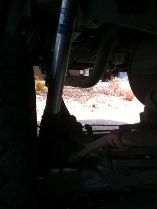

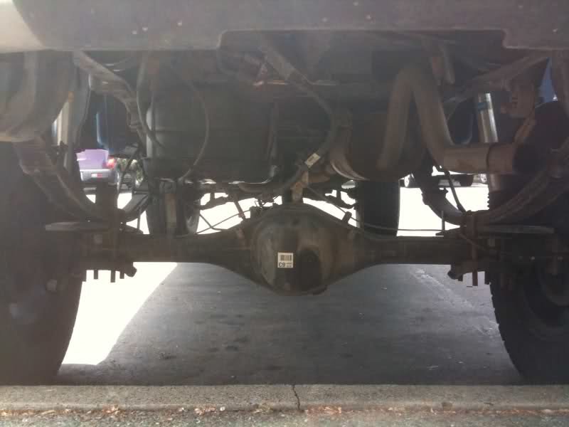

    Here are some waay berrer pics. Ill get some flexed out pics when i get home tonight.
