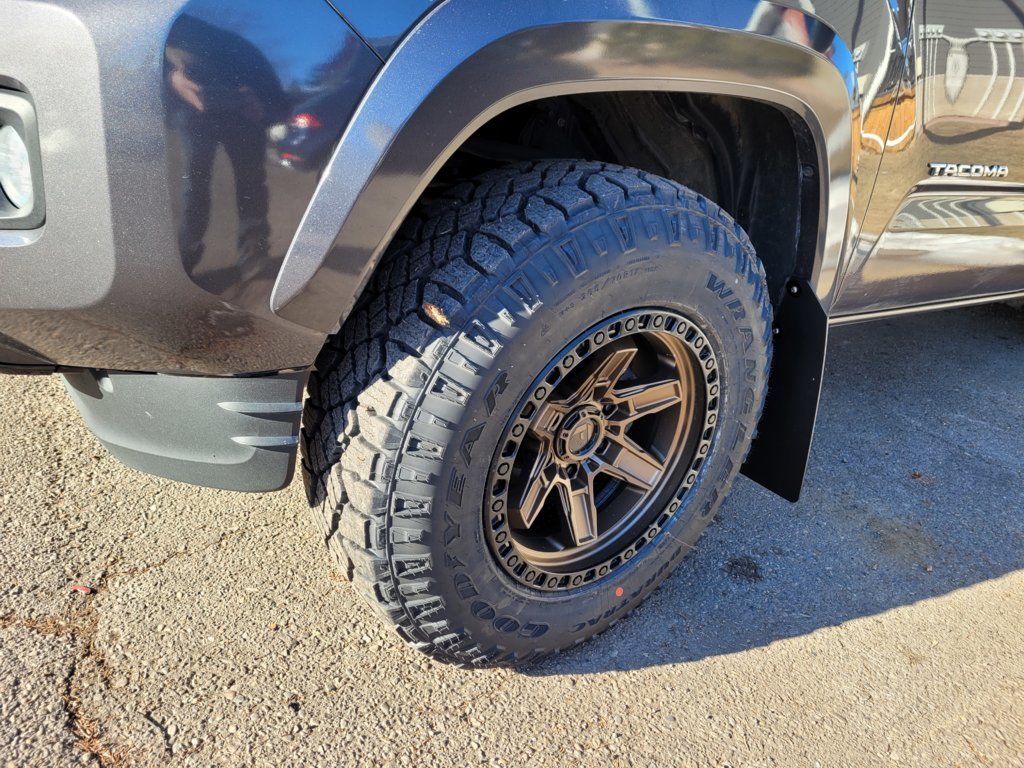

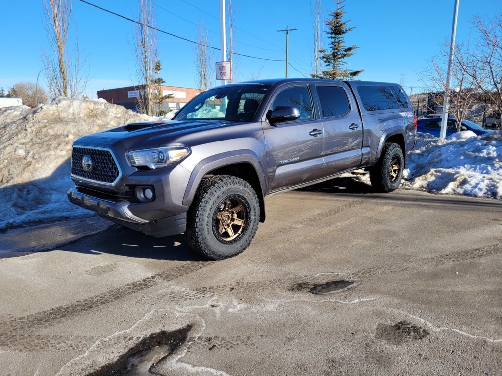

    I currently run this setup.
    I do not rub when driving around town. I only rub when I'm full lock and suspension is compressed, so basically only whenever I off-road.
    I removed the OEM mudflaps. I had an alignment shop max out positive caster which pushes the wheel away from the rear of the front fenders. If you want to run mudflaps, I suggest low profile aftermarket mudflaps.
    I didn't really bother with the rubbing since it doesn't happen 99% of the time (and if it does, only in very specific scenarios) and if it rubs, it only rubs on plastic.

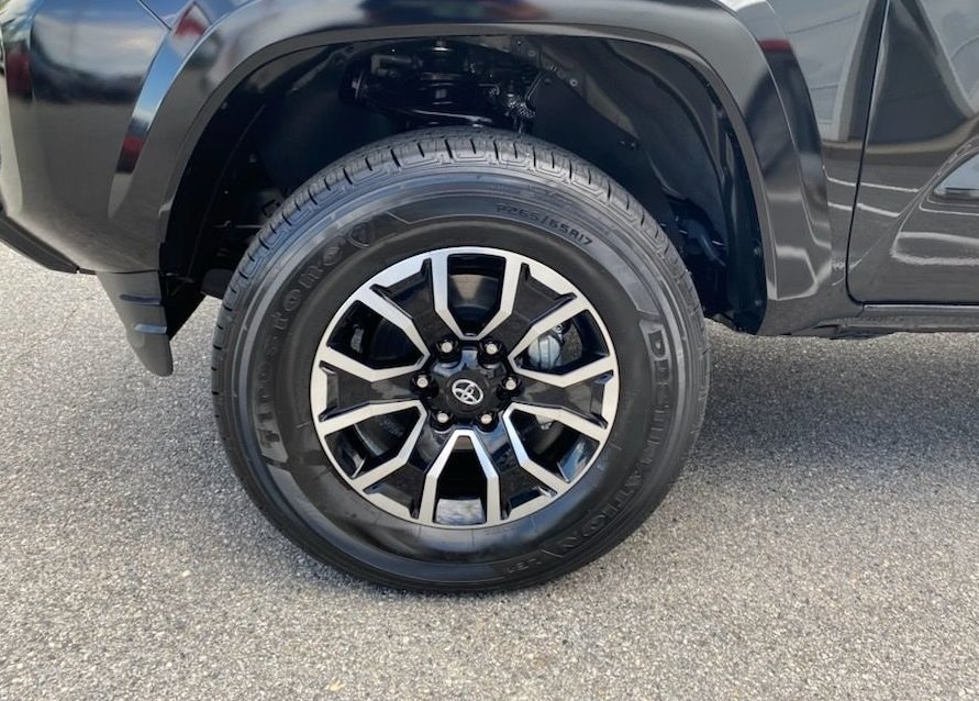

    Well, #1 you're the one who posted a pic of your tires with "lol".... #2 we can have differing opinions... My opinion, those tires are an injustice to the platform.

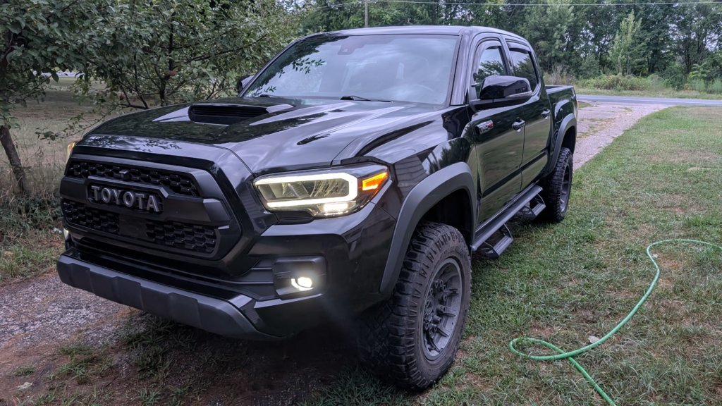

    To the OP, even just getting a modern AT tire like a Falken Wildpeak is going to dramatically help the looks. If you also get new lower offset wheels, that's gonna help your stance. If you're only going up to 265/70, it won't be an issue. My truck (picture) sits on 265/65/17, but with a 0 offset wheel for a more aggressive stance. Then you don't have the sunken wheel look (I think stock Sport is +30).PXL_20250819_002946025.NIGHT.jpg

    I'll never say you can't have an opinion! lol (And yes, those tires do injustice to truck)
    I posted my tire from photo when I picked her up from the dealership...hence the shiny sunken look! :rofl: :rofl: :rofl:
    I was waiting for OP to post pic and got a lil impatient...so I posted mine! lol
    Even now, I have the ENHANCED sunken look--lol (yes, the offset is +30 for the Sport).

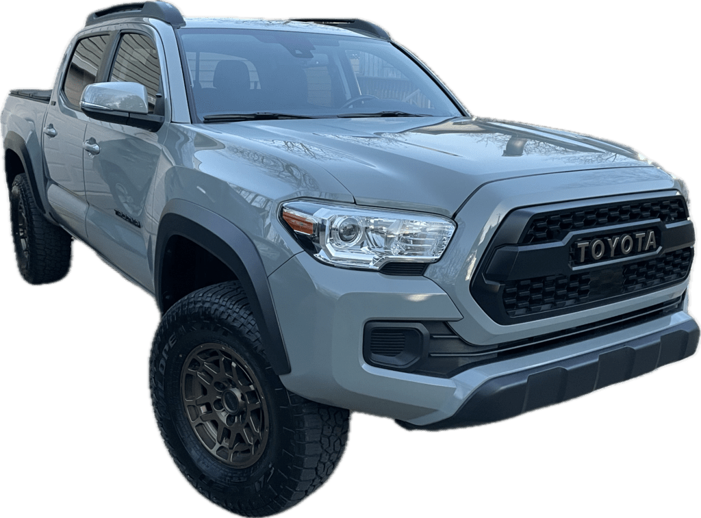

    Here's how she sits (and use to sit) at the moment. I got a nice discount and am VERY happy with the setup.
