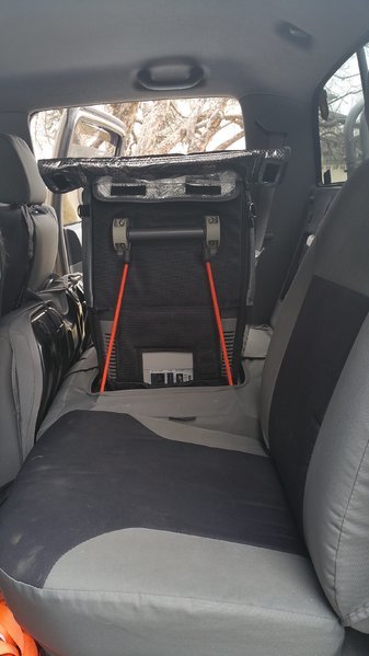

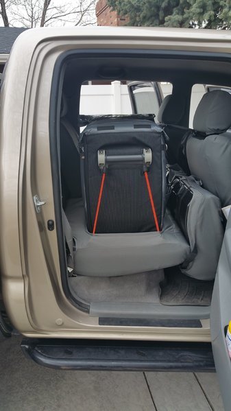

    Did a simple day test with the fridge plugged into the front socket. It sits on the 60% seat in back. I have some small d ring bolted to the back of the seat. Temp was 59° when I plugged it in and within 45 minutes it was down to 25°. Pretty impressive. Lid opens plenty far enough to access from the truck. I think I will eventually order the slide for it an put it in the back of the truck when I need the back seat for the dogs. Damn happy with this product. Thanks for the group buy!

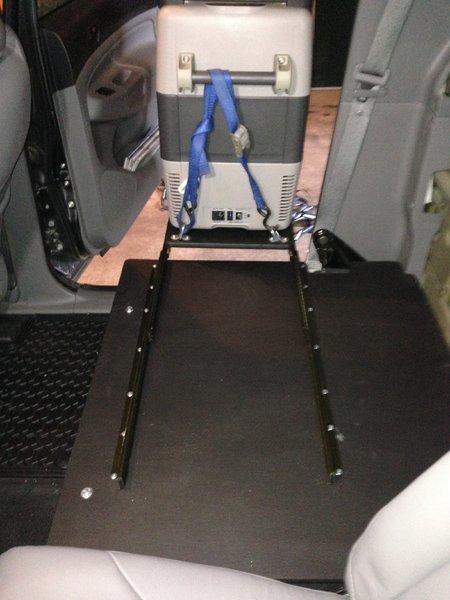

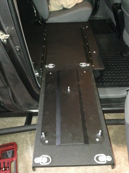

    Built my fridge slide this weekend. Pretty happy with how it turned out. Total cost less than $100. I'll do a full write up of how I built it eventually. But for now, just some photos.
    Have to touch up some of the paint a bit. Also need to grab some spring nuts from work for the unistrut that is bolted to the truck to level the base and bolt it down. It holds fine unloaded right now with just the two seat hinges. Once I add some bolts into the unistrut it should be sturdy as hell.

    I notices you strapped the fridge while it was on the mounting plate. Do those 3 pop mounts NOT hold the fridge tight enough?
    Awesome slide and platform BTW.

    It was ordered with the fridge. Came attached to the bottom.
    The straps were added more of as an insurance policy. The mounting plate pop mounts actually came shipped too tight. As I mentioned in an earlier post it was impossible for me to remove the plate from the fridge without unbolting it first. I loosened off the pop mount brackets a bit so that I could remove the fridge from the plate without feeling like I was going to break something. I didn't want to have to fight with the pop mounts everytime I removed my fridge from the truck so I loosened them to a point that was manageable. It still holds fairly tight, but just to be sure I added the strap down points. Although the sliding base is probably a bit over engineered with plate and the straps I'm still glad I bought the mounting plate because it provides a nice base for the fridge to clip into and also prevents it from sliding around on the base.

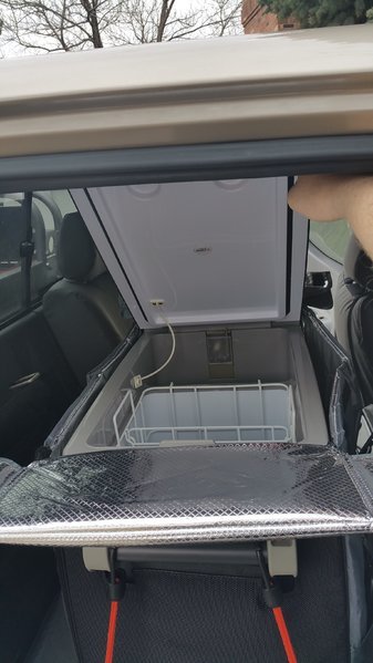

    I recently returned from a 3 day trip. I used the fridge the entire time and man this thing rocks. I should have done this a long time ago. I also added some stickers.
    A7E260E2-49E8-4453-9660-C43F5187B15E_zps_f74159ceb7315e02def897fea65bc918c1ed0c34.jpg
