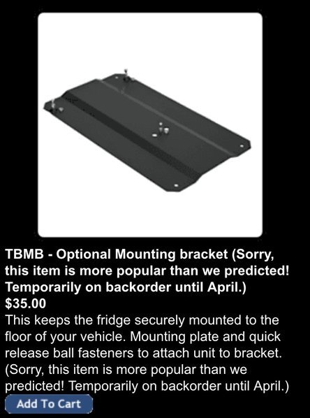

    Not sure where you are seeing that info. Pretty sure the ball fastener plate is the correct mounting bracket.

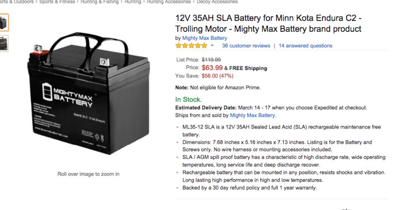

    That will work, but it won't get you much run time with the battery. I forget the stats on the fridge, don't have time to look them up right now. If I recall correctly it draws 50w or 4.16 amps when running. It obviously does not run all the time and cycles on and off.
    It is a good thing to keep in mind that you should only deplete a battery to 50% of its charge level before you should be recharging it to prevent damage to the battery. So even though the battery is rated at 35Ah (amp-hours) realistically you only want to use half of those before you should be recharging. Meaning you only have around 17.5 Ah to work with. If I'm correct in what the fridge draws that would only give you around 4 hours of constant run time before your battery would need to be recharged.
    I'd run two or even three of those batteries in parallel or simply upgrade to a larger battery. Another option would to get a cheap solar panel/regulator and hook it up to your battery to help offset the load and facilitate recharging.

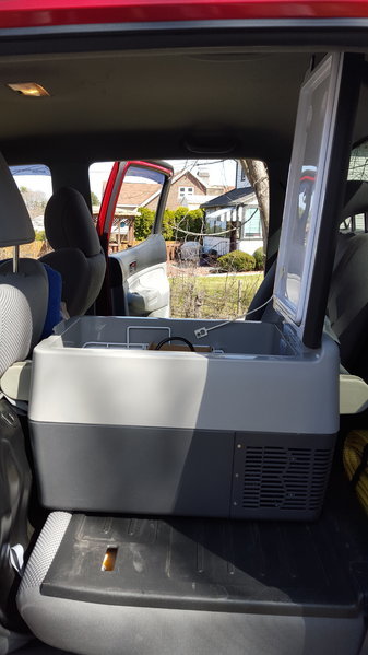

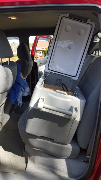

    For future reference, here are some pics of the 30L in the back seat.20160312_121505.jpg 20160312_121654.jpg

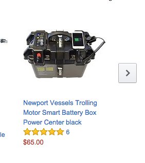

    I ended up going with the Newport Vessels battery box, but with a Group 31 Optima yellowtop. The box actually doesnt fit a group 31, even though it had previously mentioned it did. It only fits width and length wise, but the ceiling of the box is too low for the height. I spoke to the company and they reimbursed my money but let me keep the box. I had to remove the inner ceiling and have the 12v plug actually hang out the box so the group 31 works. It works great now! Its a bit uglier, but works.
    I tried it for 3 days and it threw the E1 sign after 3 days of use on it. It was on the high cut off. I switched it to the low cut off after a full recharge and it stayed on from Wed-Sunday (friday-sunday was spent at the Desert, Chuckwalla raceway). I am pretty happy with my purchase. I am thinking of getting a cheap solar panel set up thats set up in the truck to be used for week long trips.. or just having a wire thats connected to the alternator that i can just swap onto the yellowtop while we are moving.
