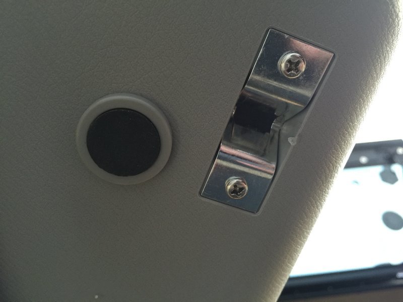

    How does the fridge disconnect from the mount?

    There are three spring clips in the bottom of the fridge that grab pins that stick up from the base plate. I did 100 miles offroad last month and the fridge stayed put. I have taken the fridge out of the truck a few times and removing it from the base plate wasn't easy, so make sure you bolt it to something solid before you snap it on.

    Mounted in my the bed or cab? Think you could grab a few pics when you get a chance?

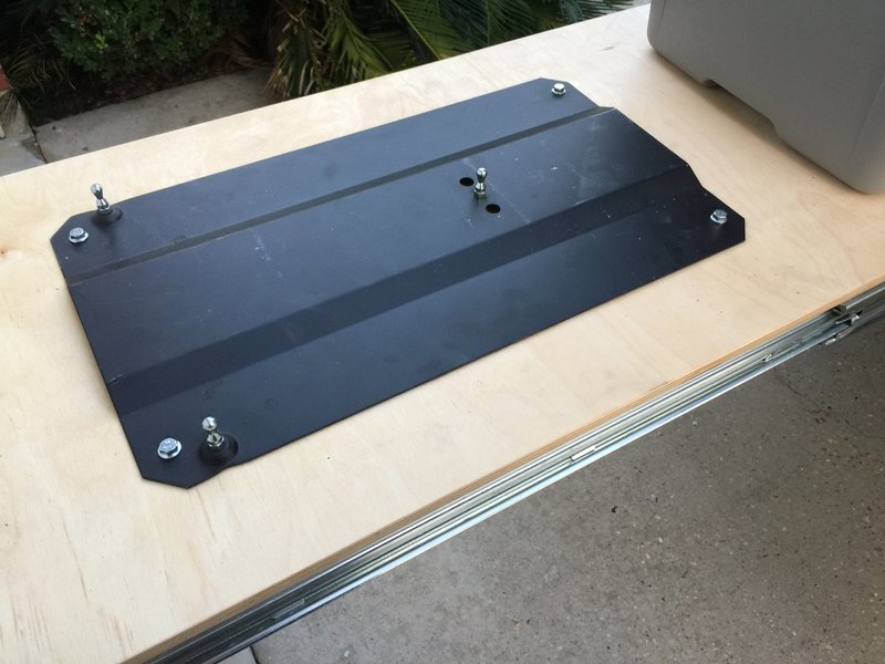

    Mounted in the bed. My combo slide for the bed isn't quite finished, but the fridge portion is.

    I'm sure you could mount the plate to the seat securely. The problem would be changing the orientation. Once the plate is mounted you would have to flip it around every time you flipped the fridge.

    Also, the mounting holes on the base plate are not in the same place on each end.

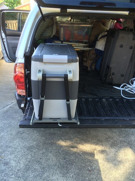

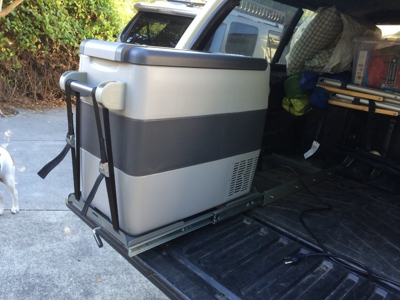

    image.jpg image.jpg Finally mounted the slide and took my second trip with the fridge...

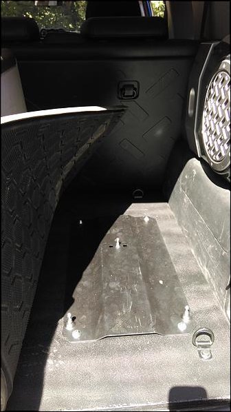

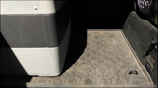

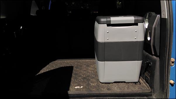

    Mine froze water at 34 deg and eco mode, so I'm guessing it will be tricky. ;) Might as well post how I mounted mine while I'm here. Also for anyone else reading this, don't be afraid to email the guys at truck fridge like I did. They often have sales going on. :D Stealth mount, never came loose during an 8 day wheeling trip in Moab and Colorado despite my best attempts. Left it running the entire time too off my single lame battery.
