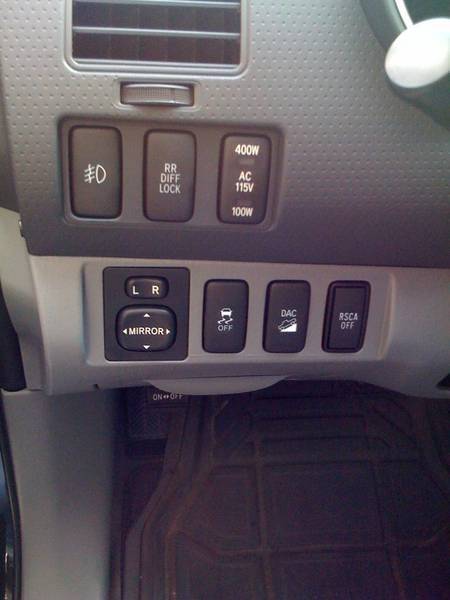

    do you have any blanks to the left of the steering wheel?? thats where i mounted my sitch.....right beside where the locker button was in the 06 i had.............and i have seen people modding the black plugs there with a small switch, sometimes being the switch that came with the lights. if your switch was like the one i had that came with my hellas...it was too big, so you can get a cheaper,smaller one that will work from autozone or advanced.

    No, there were no open spots on the left of the steering wheel. All used up with stock applications:

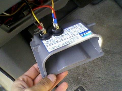

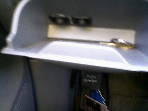

    I am very satisfied with the brightness of my lights. I have the middle two straight ahead and the side ones pointed out a little to see whats on the sides of the road. those along with my HIDs light up everything great!
    I am using the switches that came with them. I mounted them in the little storage compartment on the left of the wheel under all the factory switch places.
    I popped it out, cut out two holes in the back of it and mounted them. Ill take a pic here in about 30 mins when i got to lunch

    gotcha!! i forgot you had all the added options that the 06 i had didnt have. i had 3 open spots there.

    ok here are the pics of how my switches are mounted. sorry for low resolution, i used my cell phone

    good place for the switches man!!

    Keason1 - That is a great place to hide switches for things you will only use intermittently!

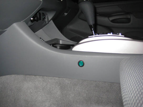

    Ok, so I got the switch done and here is a pic of the lights on.
    Switch - very limited options on switch location. I'm not really happy with this location, but it's what I've got.[​IMG]
    Lights lit up

    Alright man, looks good! glad to see you got them working. and I like that location, just not the color of the switch...haha
