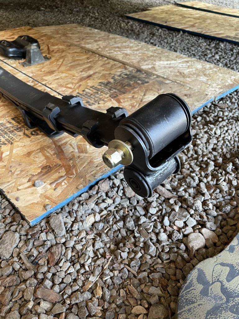

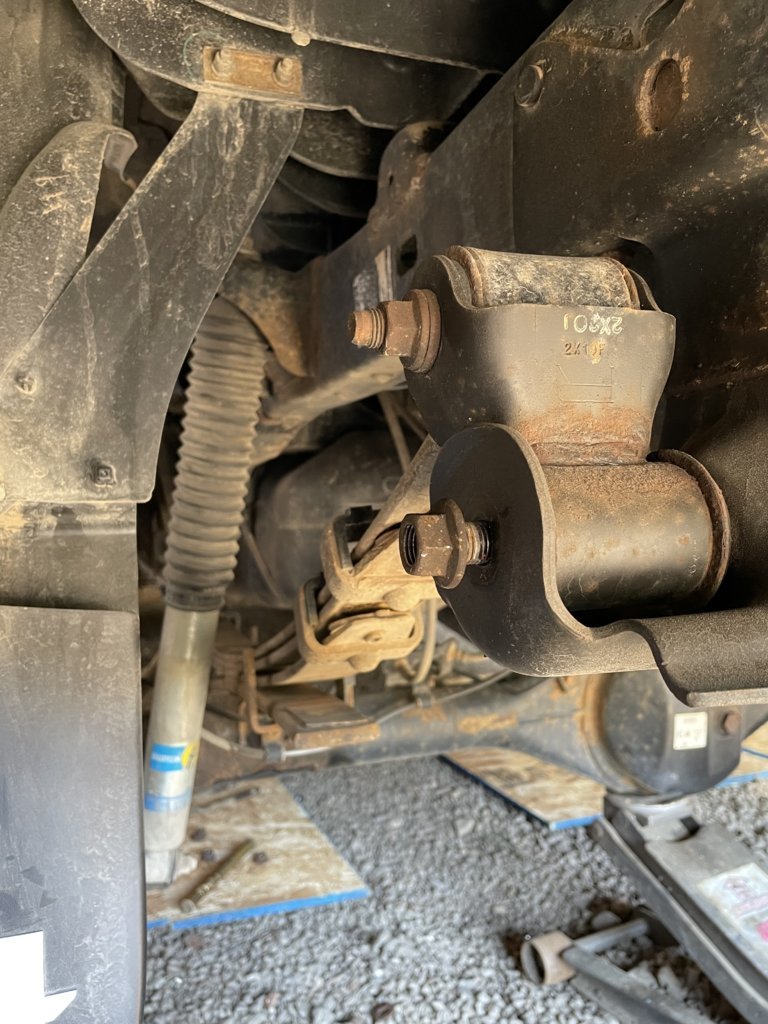

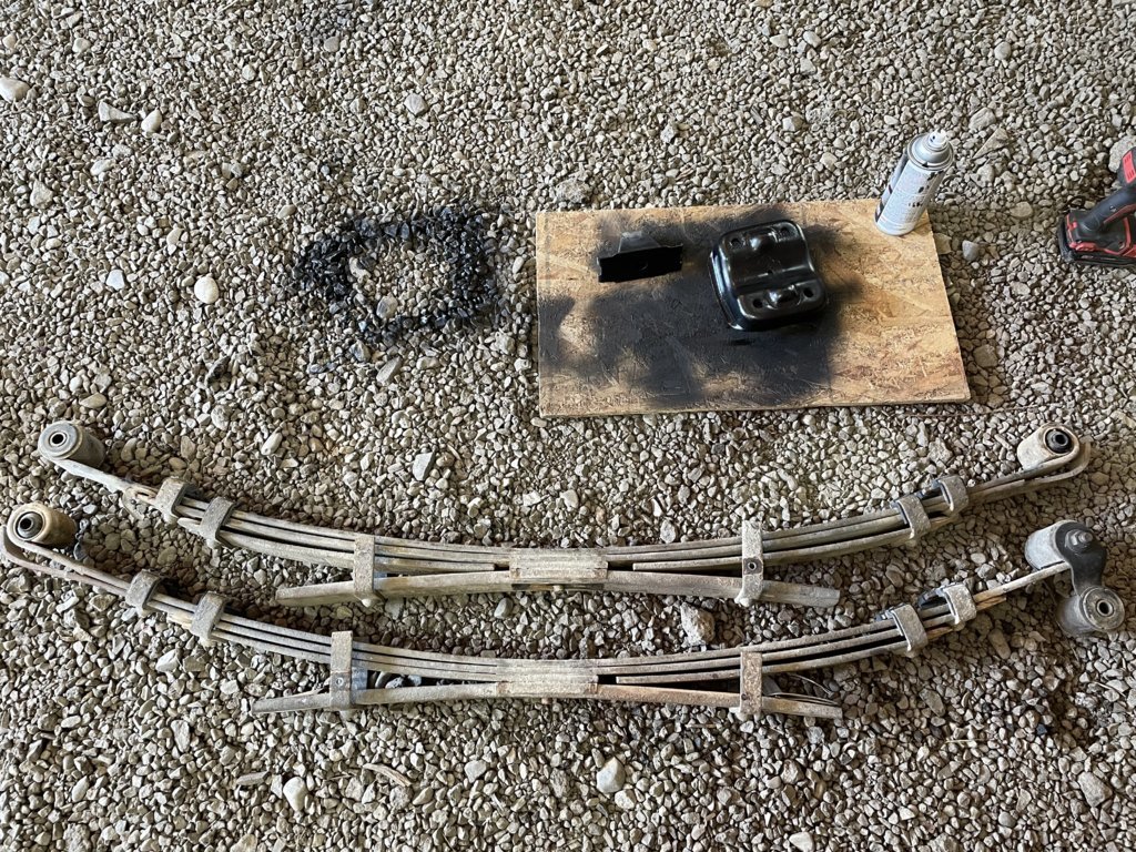

    Torspd, HondaGM and Crow Horse[OP] like this.

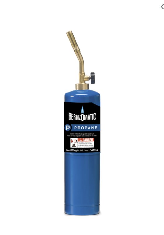

    Next time try a cylinder of MAPP gas, it burns much hotter than propane.

    Nice, but you can tell that truck isn't from the rust belt. Up here in salt country, the amount of rust on yours would be equal to a 2-year-old truck.

    I don't think you can get MAPP Gas anymore. They stopped MAPP Gas production in 2008 and it is no longer sold in North America. There is an alternative, but it isn't MAPP Gas, and not worth the added cost.
    BLUEFIRE Modern MAPP is a modern substitute to the traditionally known MAPP fuel gas, which was discontinued since 2008.
    Currently, our product is the only real original MAPP gas substitute available in the North American Market.

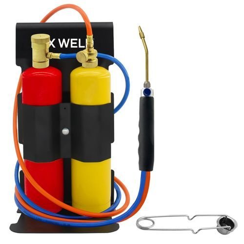

    IMG_0499.jpg A mini torch like this is also a decent substitute for a full on torch at home. I got one from Canadian tire for home tasks.... may not help the OP with his concern of working near his barn but still useful. It can be used with propane or map gas
    My only note is that any sort of decent heating jobs will basically drain an oxygen bottle per job and the oxygen is the expensive gas
