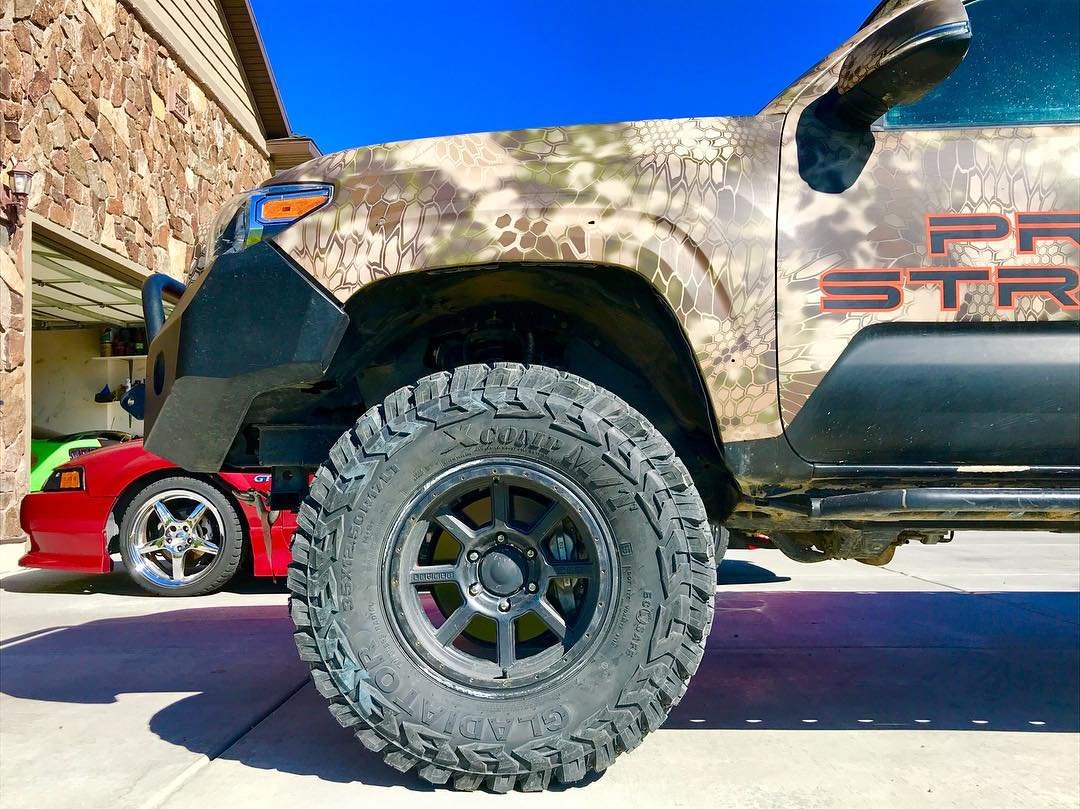

    So I’ve been trying to do a little research and haven’t found exactly what it is I’m looking for. I know there’s usually a lot of knowledge on TW so here goes.
    My DCLB 2016 Tacoma TRD OR is quite PORTLY. I threw it on the scales today and was surprised at how much weight I’ve actually added. She now tips the scales at 6480 lbs! Yep. I’ve added 2000 lbs to this beast. But I digress. I’m now running 35x12.50R17 inch tires which are load range E.
    I know that the door placard tells me put 30 psi in stock configuration and obviously that's no longer correct. So how do I figure what psi I should actually be running now with the added weight and oversized tires? I tried to find charts online to tell me but nothing was very helpful. Obviously I want to get as much tread-life as possible considering the changes I’ve made.
    44302803_2023315351045626_70389617203326_112cc8c669b58441a9e0ee7897ad1aaa5362cc97.jpg

    Based on the picture in the OP, you're definitely running too high.
    b00gieMonster and tonered like this.

    Wow! That's a lot of plasti dip! :cookiemonster:
    4x4_Angel likes this.
