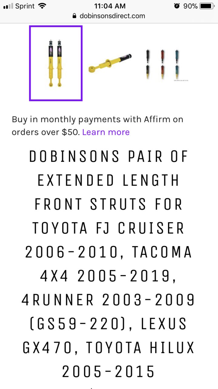

    I've searched and been surprised to not find inexpensive extended travel shocks on the market. To get that extra 0.5" (~1" of extra wheel travel) it looks like you have to go Icon, Fox, King, or equivalent extended travel shocks and the price point jumps 2x over a "normal" shock. It would be nice to get the extended travel that an aftermarket UCA allows without doubling the price of the shock.
    In theory, 1" of extra wheel travel would allow one to push the lift above 2" with less risk of issues caused by the lack of down travel (e.g. ride quality). Please educate me if this is a bunk theory.
    Can anyone explain why this is?
    Does anyone know of an inexpensive extended travel shock?
    Note that I realize that the Icon, Fox, King, etc. shocks have other advantages, but I don't want to get into that in this thread.
    I also realize that lifts over 2" have the risk of other issues, e.g. CV angle, etc., but I don't want to get into that in this thread.
