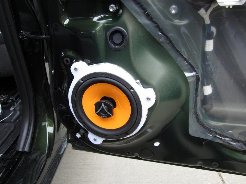

    A coat hanger with a hook in the end and some graphite lube go a long way in completing this.
    My system is considerably more than $200 (that's not a boast, just a statement of fact), but I've managed to find good deals over the years on other systems, like a set of Pioneer component speakers on clearance for $40 that sounded awesome.
    I've also heard the JBL systems in Toyotas before and they are no hell. Muddy and lacking in definition. Fine for my ex-gf, because she doesn't care, but I can't stand it sounding like the speaker is in the bottom of a five gallon pail.

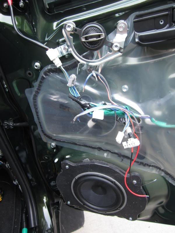

    The stock Toyota speakers are plastic baskets with a magnet that's about the same size as a Coke bottle cap. The plastic ones, not them old fashioned metal ones.

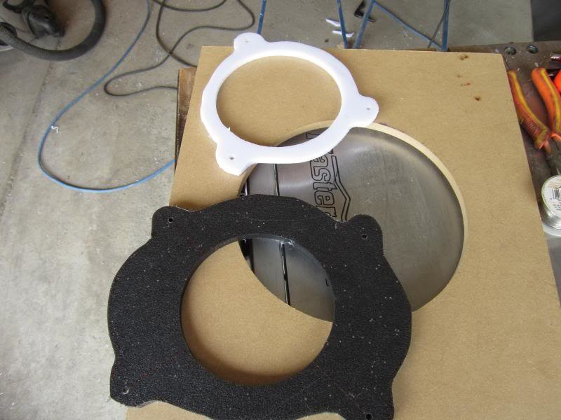

    You'll need speaker adapter rings because of the oddball sizes that Toyota uses. If you have a jigsaw and some HDPE cutting board (cheap at Wal Mart), you can make your own by tracing the pattern of your old ones. A router with a circle cutting bit makes the holes much nicer, but they can be done with the jigsaw.
    (The white board cut nicer than the black one, which seemed far more brittle).
    I sound deadened the doors and the areas around the speaker adapter rings. You don't need to cover the entire inner skin of your door. In fact, 25% coverage is probably enough. That saves a few bucks. All products like Dynamat do are cut down on panel resonances. They're not a sound absorber at all.
    What you also need to use is a vinyl backed, closed cell foam and glue it over your sound deadener. This absorbs the higher frequency noises. Use the 3M Super Trim Adhesive to adhere it to your door skins. The 3M 77 won't hold up to the mass of the vinyl.

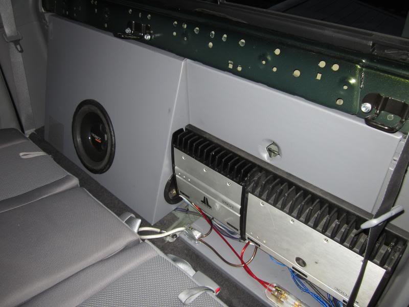

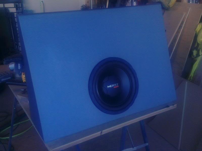

    My sub enclosure was about $20 in materials to build. Problem is the hundreds of dollars in tools required ;)
    My two JL amps cost me a total of $350. The Slash 300/4 was a demo model from a local store that they let me have for $200 and the Slash 250/1 was an eBay find for $150.
    Anyhow, if you have any questions, I'd be happy to help.

    Do those adaptors come with some type of gasket so they dont rattle against the door?
  18. Feb 24, 2016 at 10:45 AM
    #38
    Thomas Jefferson
    Thomas Jefferson Keyboard Warrior
    Jul 8, 2013
    #107851
    1,291
    Sacramento,CA
    '13 SR5 DCSB 4x4
    One can never have too many light bars.
    Yeah it comes with this foam tape that You put on the door and screw in the speaker over them. It looks and feels cheap but they work pretty well.

    FYI those adapors did NOT come with any foam insulation. BUT the hardware store had 1/4in wide 1/8th in thick closed cell foam tape for 3 bucks that worked like a charm. Those adaptors for the rear door worked out GREAT, i got the rear speakers in last night and once the fronts come ill do the fronts. I can already tell the difference.
    Also the wire harness adaptors worked like a charm.
