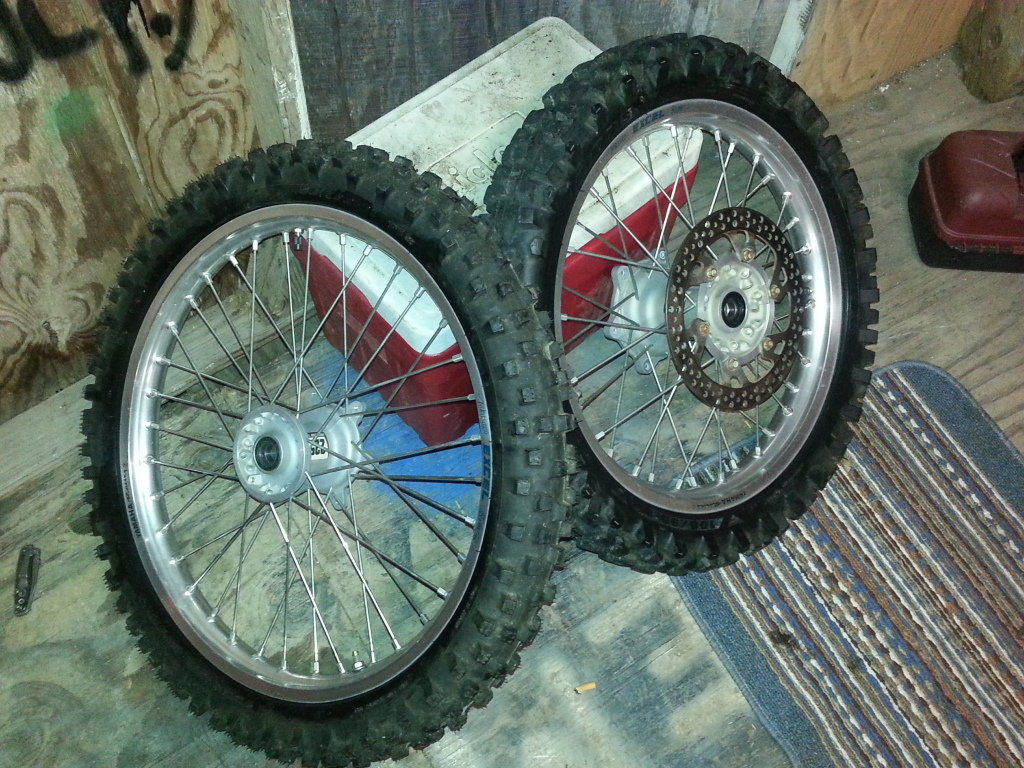

    Sort of forgot about this thread! Anyway the bike is ALMOST done. Just a few odds and ends left to pick up. Managed to get it cranked up and running for about 20 seconds.
    Here's the tires mounted on the Takasagos.

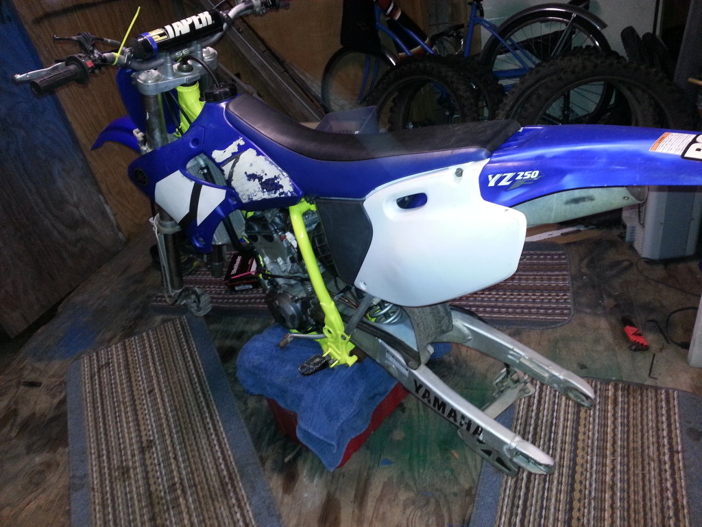

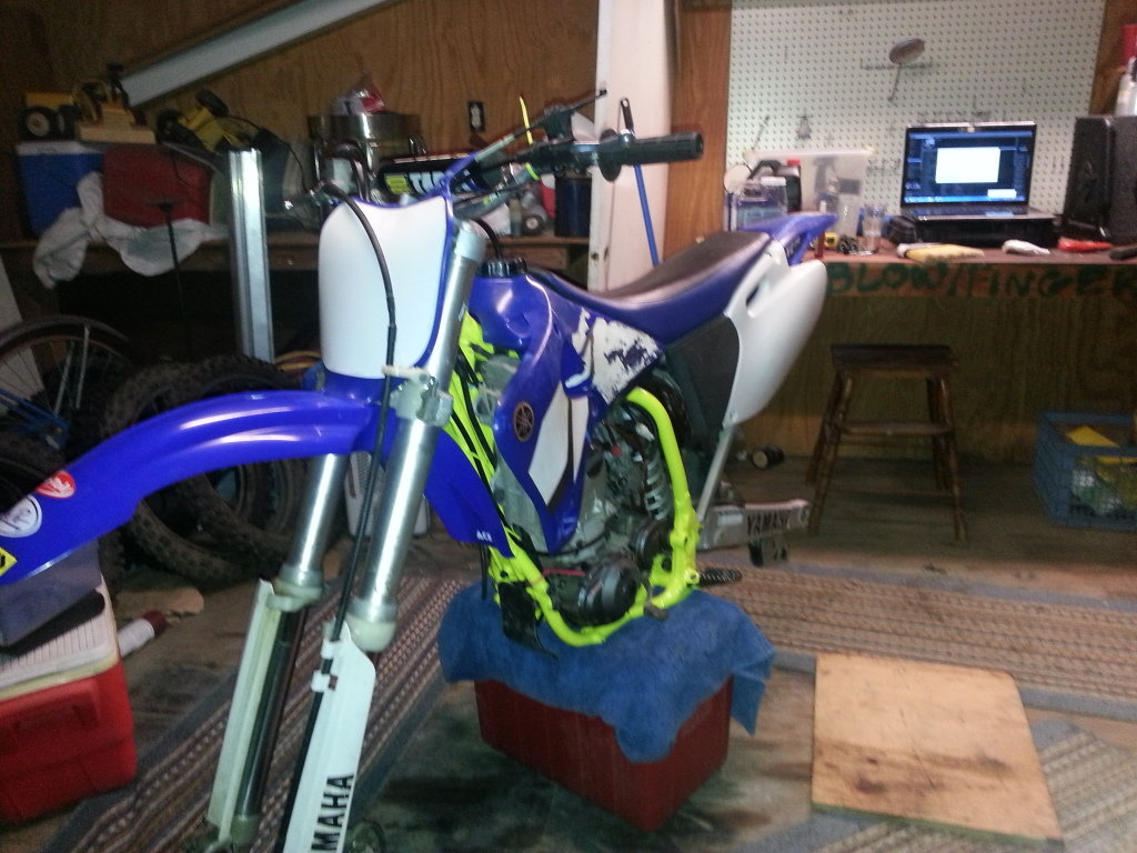

    Reviving it!
    Went home for a weekend and got this bad boy 99 percent together. Got it tuned and running right. Brought it back up to my new house. Just ordered the last of my parts. Had an antifreeze leak. Pulled my water pump cover expecting to find trouble. Just a bad seal. Clean as a whistle in there too!

    Ordered the wrong seal. Turns out it was leaking out of the weep hole, so next weekend ill be swapping out the inner oil seals on the impeller shaft. Other than that still chasing down some bogging issues. These fcrs are a bitch to tune.
