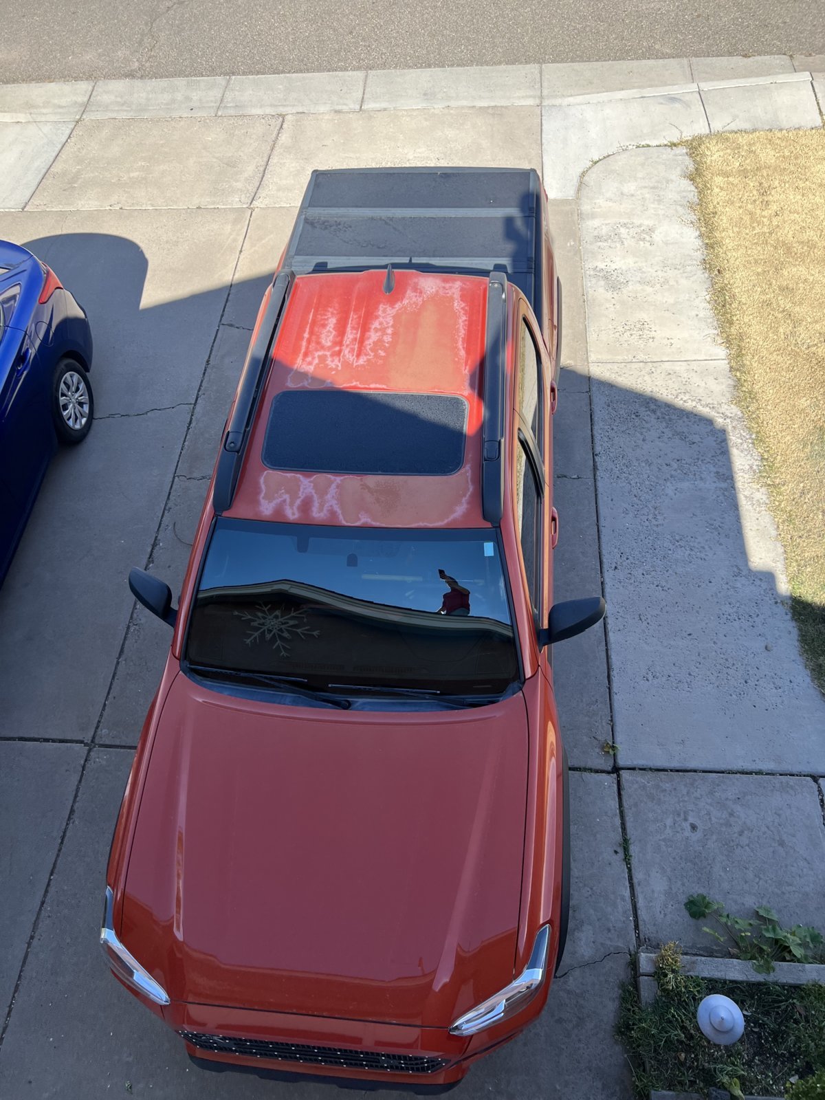

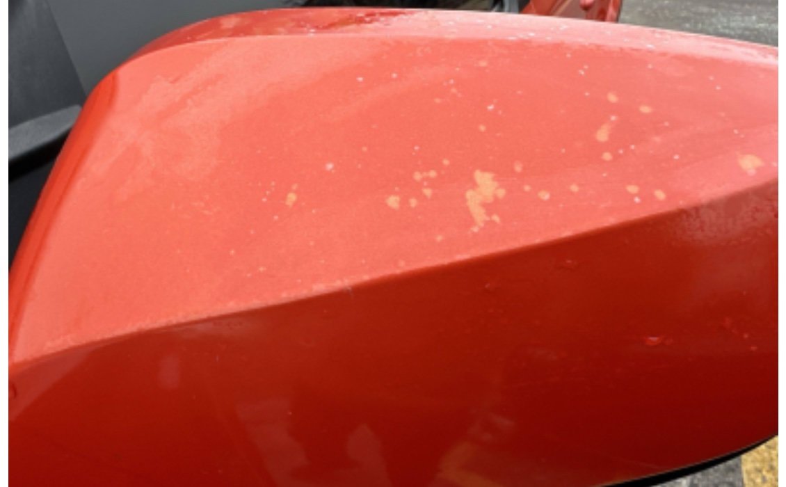

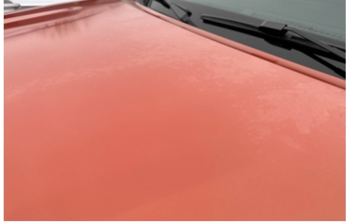

  9. Mar 28, 2024 at 8:35 PM
    #69
    4betterdayz
    4betterdayz New Member
    Mar 28, 2024
    #446818

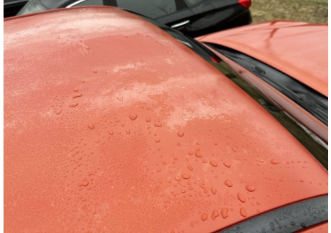

    Here are some photos of my 2017 Tacoma at 70k miles. Roof, hood and mirrors are shot. Went through dealer where I bought it and since warranty expired nothing they can do. I have 4 Toyota vehicles of 4 different colors and ages and this being the newest. Something wrong with that right there. Very frustrated!!

  10. Mar 29, 2024 at 5:51 AM
    #70
    TSAVO
    TSAVO Well-Known Member
    Mar 15, 2018
    #247434
    971
    Tempe, AZ
    2018 TRD OR
    My 2018 did the exact same thing and I got no help from Toyota either. Now it’s starting on the rear upper corners of the front fenders.

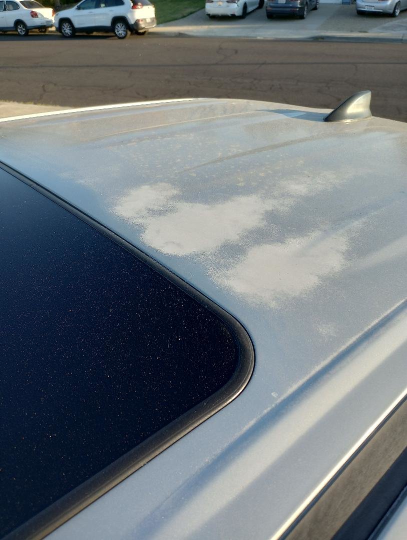

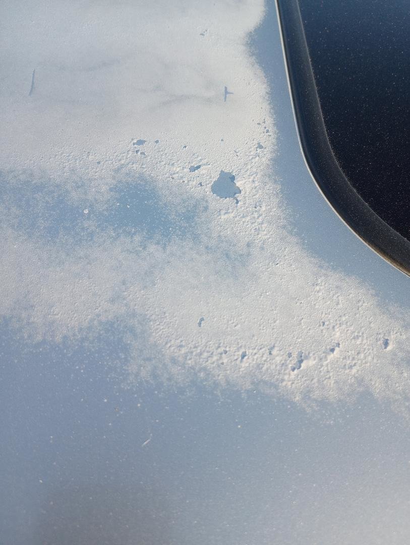

  17. Aug 4, 2024 at 2:10 PM
    #77
    LS14ME2
    LS14ME2 Kind of a big deal
    Jan 30, 2017
    #209132
    489
    In hiding, CA
    2017 SSM Sport DCSB 4x4
    Center console divider thingy, rubber bed mat and side steps for the wife.

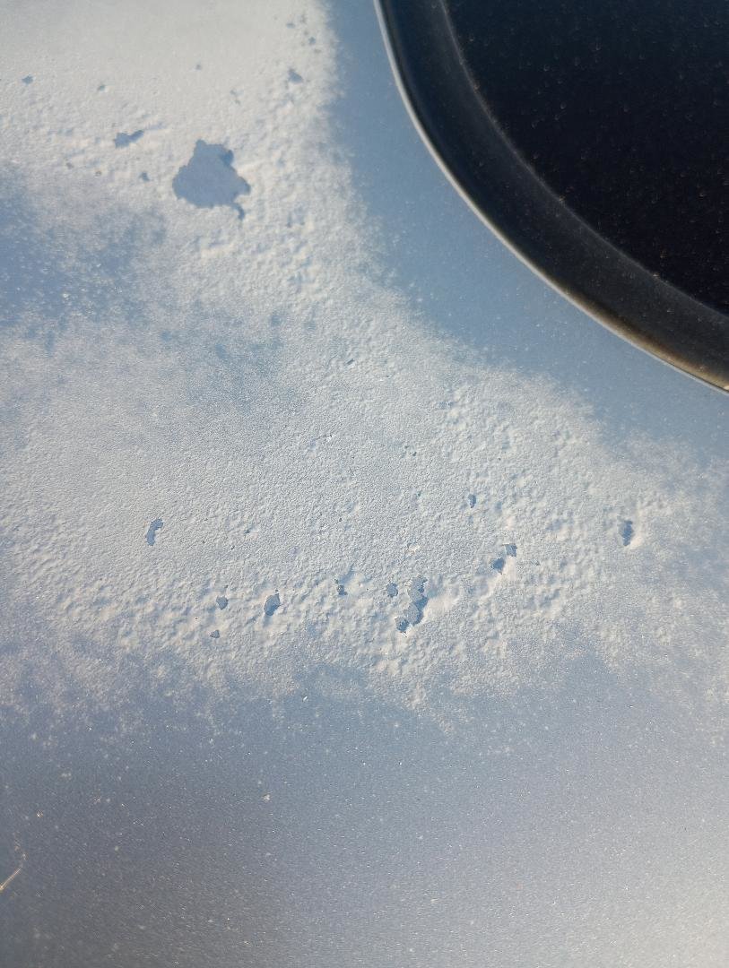

    Here is my 2017 SSM. 26K miles, always hand washed and waxed. My 2013 red Avalon sits in the same driveway and has none of this. The Tacoma goes to the shop tomorrow for roof paint. The clear is actually flaking off.

  20. Nov 10, 2024 at 3:03 PM
    #80
    LS14ME2
    Jan 30, 2017
    #209132
    489
    In hiding, CA
    My 2017 had the roof clear that failed and when it started, it got worse, quick, and like you, got to a point that I just had to get it fixed.
    Took it to a paint shop that prepped the roof after removing the HMSL and shark fin, re-sprayed the color and then new clear. Replaced the old HMSL with a new revised light so no silicone or bezel. Looks soooo much better. Cost me $2000.00
