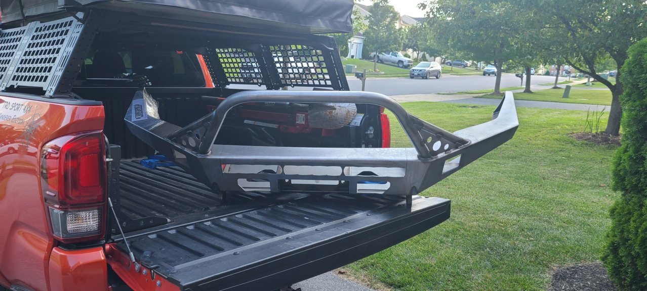

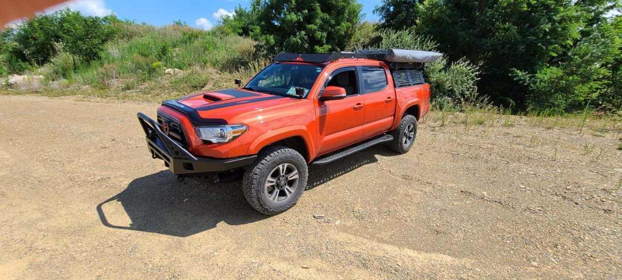

    Did some stuff.
    So this came in a month ago. I used the weekends to prep and let it sit during the week as I tend to rush paint projects. Following the wire wheel and degreaser was two coats of self etching primer, then a roll on bedliner without the rubber pieces mixed in. The roller gives it the texture.
    Saturday was prep the bumper with winch and light mounts at a good friends house. Then home to install the sliders. Sunday was bumper day followed by spooling the winch on Monday.
    Relentless Fabrication's Summmit bumper with center hoop and filler plate. Ironman 4X4 9500 lb winch, Diode Dynamics SS3 Sports (new) on the bumper, and Rigid amber hyper spots (transferred from the bull bar) for the pea soup drive by the map fog. Also added the Cascadia flip up (or down in my case) lisence plate braket that mounts on the hause fairlead.
    Explore Overland's bolt on sliders. Purchased raw. Cleaned, self etching primer, and Rhino Liner 1k rattle can bedliner. This I rushed to get the installs done. We'll have to see how it holds up.
    Ironman 4X4 winch came with 95 feet of synthetic rope, safety anchor with internal pouches for wieght, remote or plug in operation, and a breather with extension hose to dissipate heat. They say the winch can operate under water, but I can't help but thinking how bad the situation must be if you need to do that. I did walk the truck up the hill without an issue.

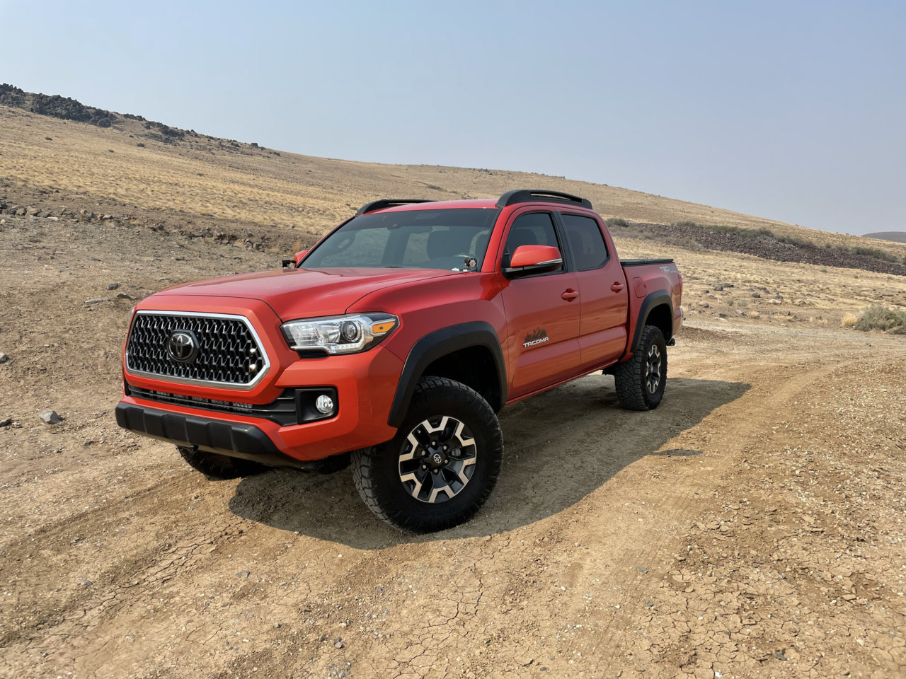

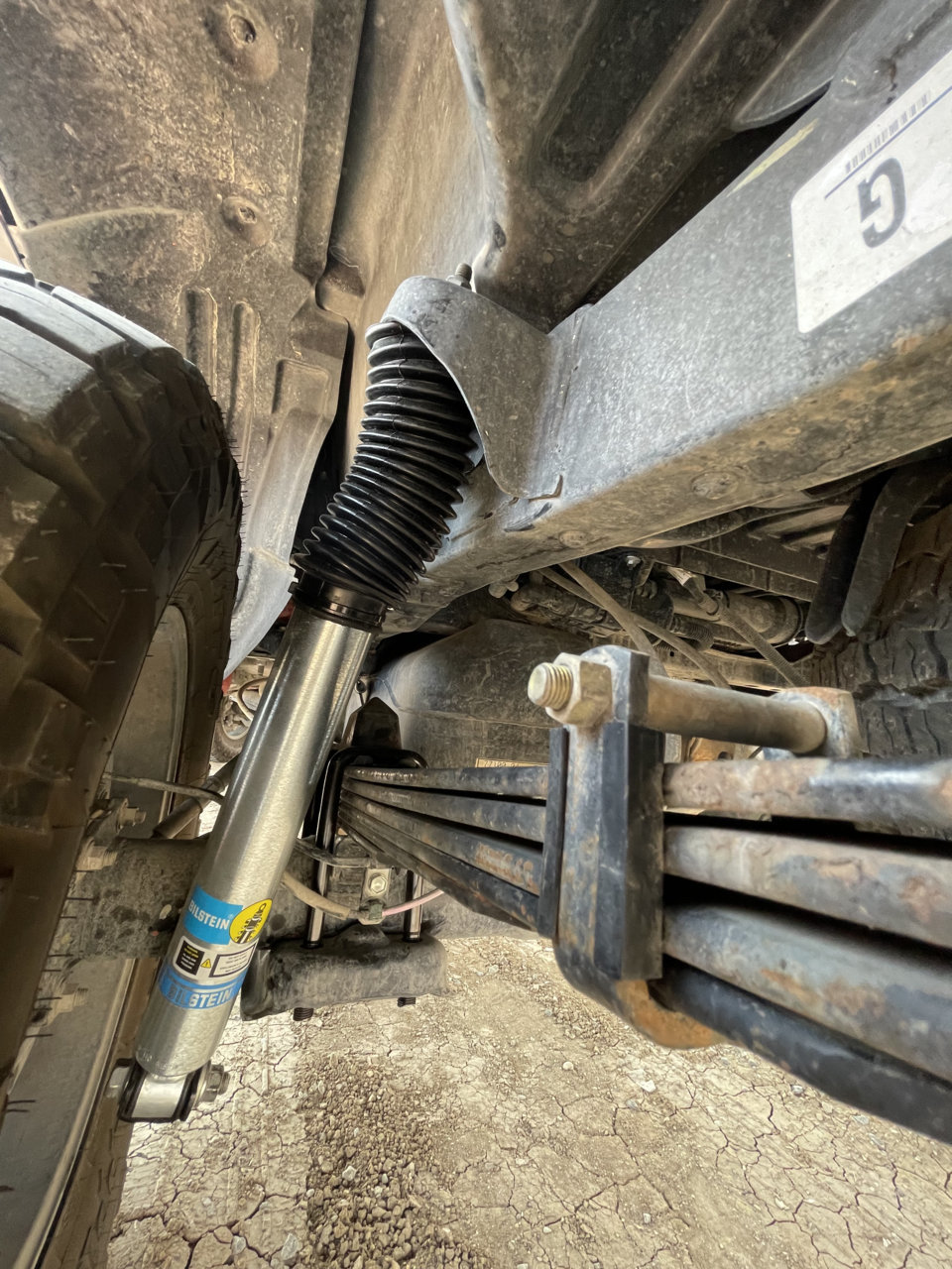

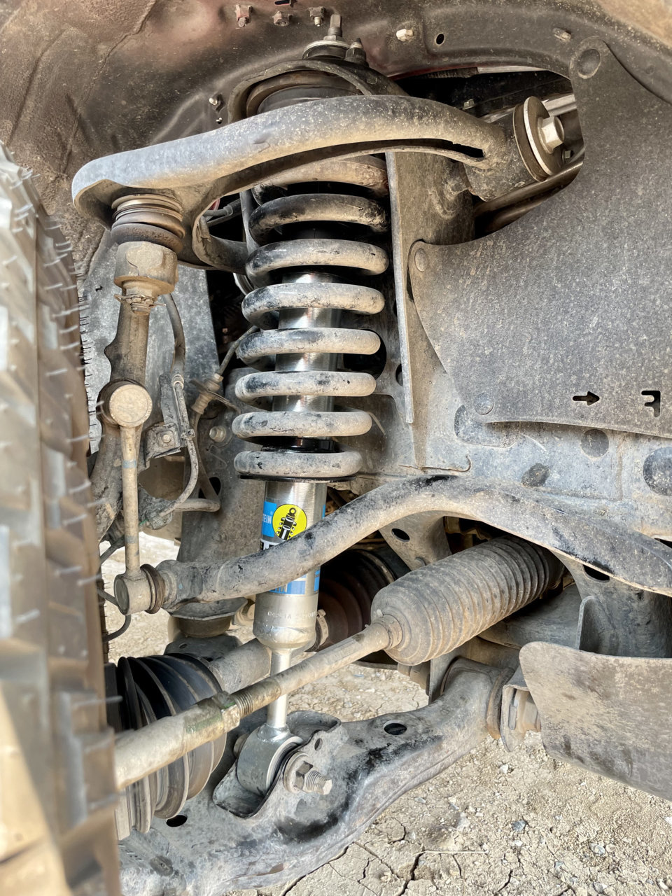

    Got a really good trash can for the back seat that I'm kind of excited about. ;) Tinted the front windows and windshield strip Glovebox and Console dividers MESO Hi/Lo LED Dome and Sylvania map lights Upgraded Sylvania down road halogen headlights Toyota Bed lights Tailgate Power Lock Anytime Backup Camera on front with switch MESO Customs Puddle Lights w/ switch OEM Roof Rack TRD Air Filter K&N Cabin Air filter MESO Customs Gasshole MESO Customs pocket switch plate ARB Awning w/ sides and back Taco Vinyl radio knob Mountain Hatch Tailgate Panel Midland MXT275 with clean set up and Ghost Antenna on roof Tonneau Cover - full fold up Cali-raised Lower bumper light bar Baja Designs ditch lights Icon Add a leaf 2” rear lift Bilstein 5100 OME 2” medium weight coil spring (settled at 1.5” lift all around) Rear diff breather relocation TacoMods ECT gear shift button KTJO4x4 A-Pillar Handle KTJO4x4 B-pillar handles RAV4 spot mirror Exhaust Re-route The last Mobtown Hidden Hitch Rear Bumper Greenlane Off road Aluminum low profile front bumper RCI Full skid plates + Cat guards Fuel Tank Skid plate Heated seats Battery Upgrade to larger AGM Soundskins sound dampening kit Randy Ellis Rock Sliders Remote Start and GPS Goodyear Wrangler UltraTerrain AT 31" tires Fumoto Valve oil pan upgrade TRD Radiator Cap Rough Country Speedometer Calibrator Oversized Cupholders Total lift: 1.5” body lift .5” ground lift On the list: Re-Gear? Speaker upgrade? Greenlane Bumper Wings?
    Had some Bilstein 5110s installed today plus installed an Icon AAL two weeks ago (actually swapped the entire leaf pack with a friend). Took it up to the dirt track so fast that I forgot to grab the old shocks from the shop and had to drive back! Glamour shot on the hill.
    With a full tank of gas, the rear settled into 1.5” higher than our original measurement and the front is 1” higher. It’s perfect and the tow hitch is 2” so all around I’d call that a resounding success. Hopefully I'll scrape the ass end slightly less frequently.
