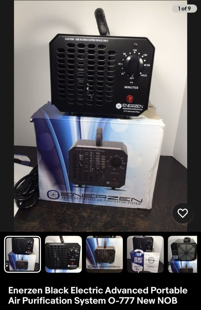

    My Tacoma had a funky old people odor (an elderly couple owned it) when I bought it (2017 TRD OR 4x4 w/ 28K on the odometer).
    I sprayed Summer Linen air freshener, replaced the cabin filter and hung Summer Linen scent trees in mine and the odor persisted.
    A friend of mine recommended this.
    30 mins on the front passenger side floor board, 30 mins on the front driver side, 30 mins on the arm rest and 30 mins in the middle of the back seat, windows up and doors closed and the smell was gone.
    After I was done, I rolled the windows down and left the doors open for several hours because the ozone smell is super strong and will cause you to cough.
    They also work great in bedrooms, kitchens and living rooms. Larger rooms take a little longer and you have to move them around accordingly (pick a direction and interval. Clockwise or counterclockwise).
